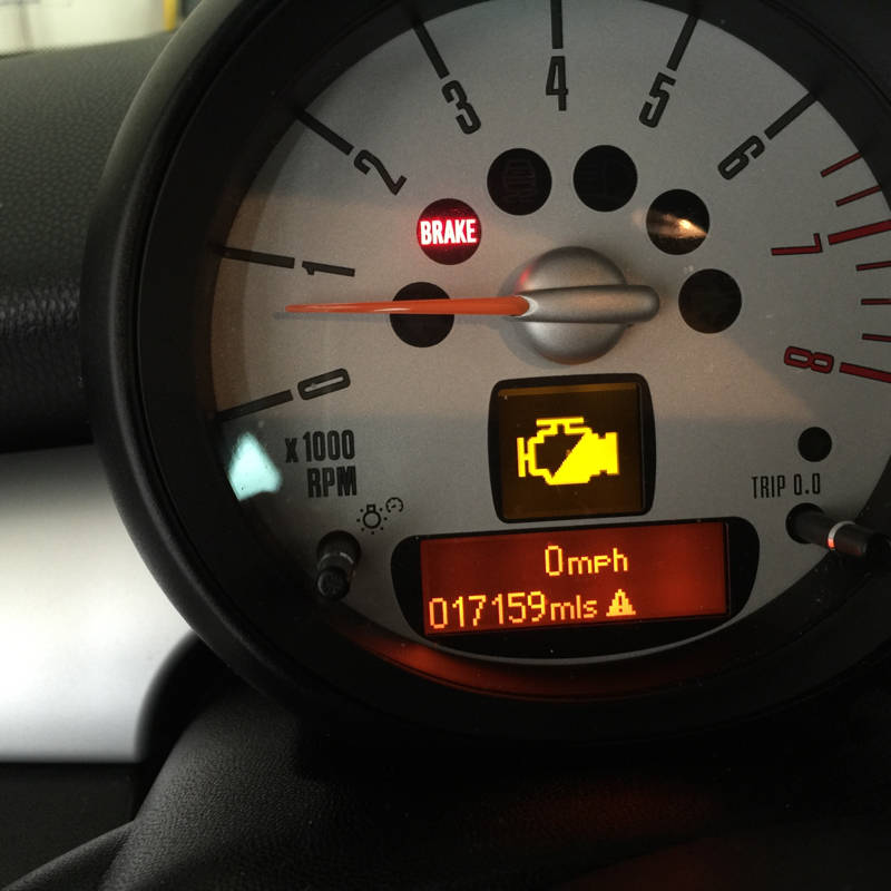

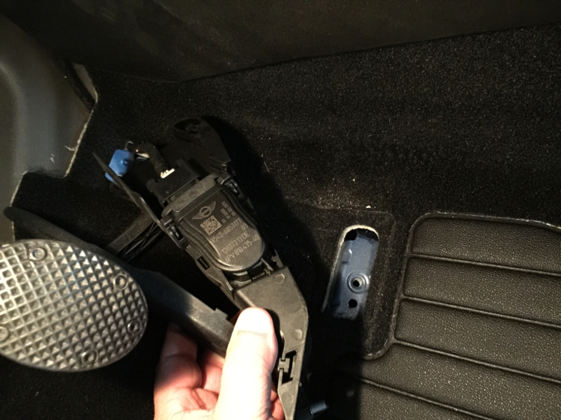

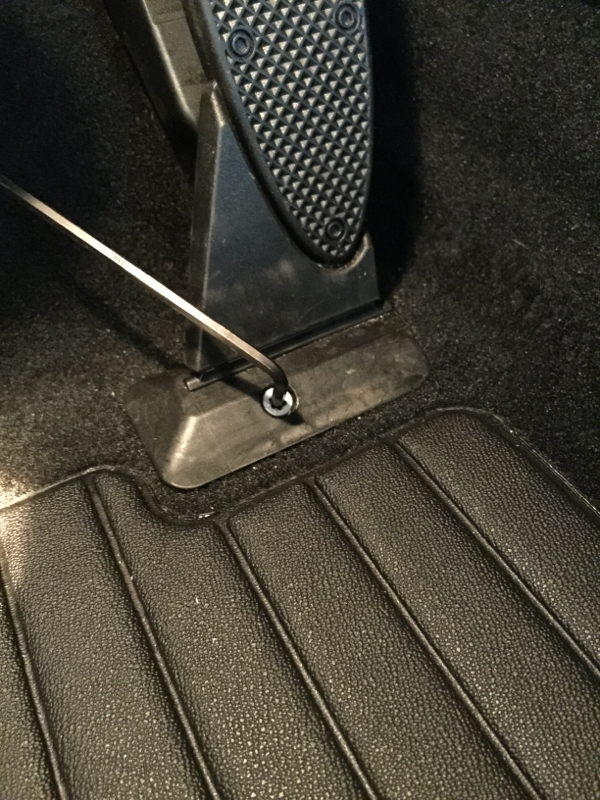

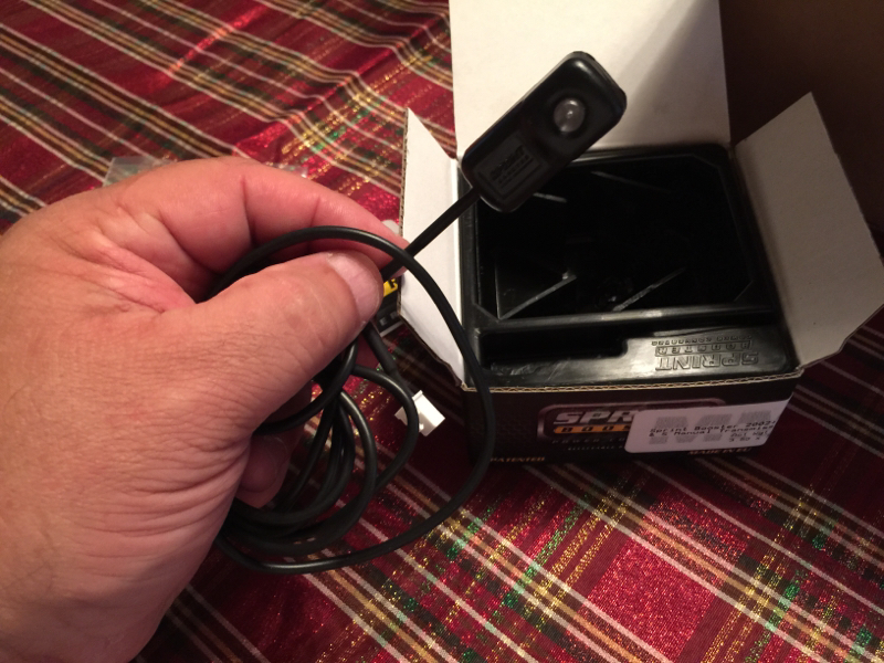

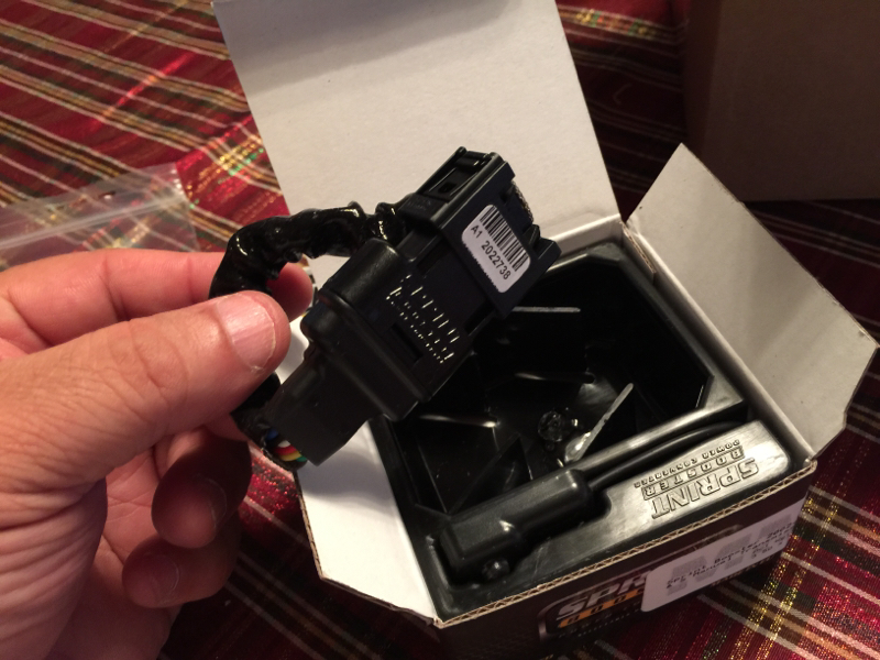

So here we go.
First, I notice a "significant" decrease in response time. Heck, I can take off on second from an almost stand still. Response at 3-4th gear is incredible.
Having said the above, I need to run/test this some more before making a final judgement call. The reason for this is as follows.
1- Installed device exactly as shown on instructions.
2- Turned car on and immediately noticed a check engine light followed by an icon that looked like a tachometer.
3- Pressed gas peddle and nothing happened. Check engine light still on.
4- Turned car off then back on again and everything worked. Ironically, my interior lights which I had set to blue, turned back to red. Odd, but I set them back to blue.
5- Drove car a few blocks, came back home and double checked all connections. They appear tight and in place. Turned car on and noticed item #2 again. Proceeded to step #3 -- same thing, then step #4.
Returned home to double check the instructions and confirm I did everything as suggested. I did.
I'm writing this now then will go back and try it again.
Best,
David
Attached Thumbnails SprintBooster-image-2568438275.jpg   SprintBooster-image-3734462582.jpg   SprintBooster-image-1343697033.jpg   SprintBooster-image-1623440719.jpg   SprintBooster-image-709555750.jpg

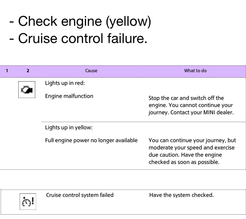

Guys - Is it normal for MINI to cycle through the check engine light and tachometer (yellow) then go away? I'm also trying something else. I removed the mode switch and it doesn't seem to do it. I'll check again and keep everyone posted.
Now, aside from the above. There IS DEFINITELY A RESPONSE GAIN. Zippy feels fun to drive, I can run in lower gears without stalling. Don't know why this is, but it's great. Except the diesel type sound she makes when to low in gear.
I also hear more of the purrrrrrrrr sound. Could it be she's sucking in more air?
Oh, I let my wife drive it to make sure it's not my butt dyno and she noticed it right away. In fact, she hardly ever "runs" Zippy, but today she had her flying. Kinda had me scared!!
Hmmmm Regards, David Sent from my iPhone using NAMotoring

Check engine light comes on and stays on. The only way to make it stay on a few seconds then go away is to turn the car off then back on again.
Sadly ... it needs to go back. :(

I found out the tachometer light is indicative of cruise control failure. :(
Don, the owner of MINIMania sent me a FedEx return label. No offer to send a replacement, no apology for the device not working, no comments at all. Amazing!

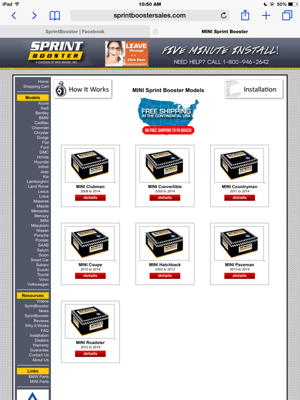

Note the center selection says, "2002-2013" for the MINI Hatchback. When I select that product it's the same part number I was sent. Note this site is also "A division of MINI Mania" which is where I purchased my SB.
