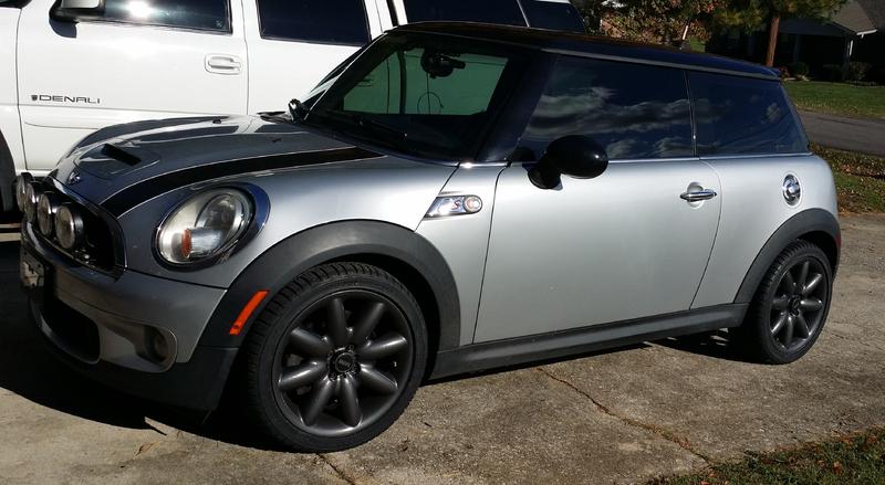

Here are the wheels...
The tires are Michelin Pilot Sport AS3. New.
They were balanced etc. at the installer. They dinna say anything about the wheels being out of round.

Mmmm s-lites.
