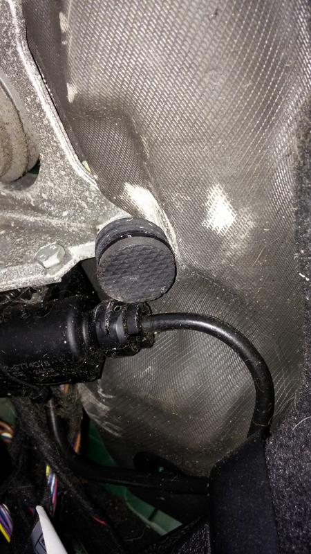

Ok, pic time as the site allows. I'll add more later if it limits it.
BMS clutch stop install
Attached Thumbnails Aelwulf's MINI-0310151816.jpg   Aelwulf's MINI-0310151817.jpg

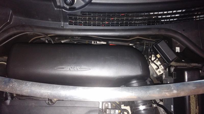

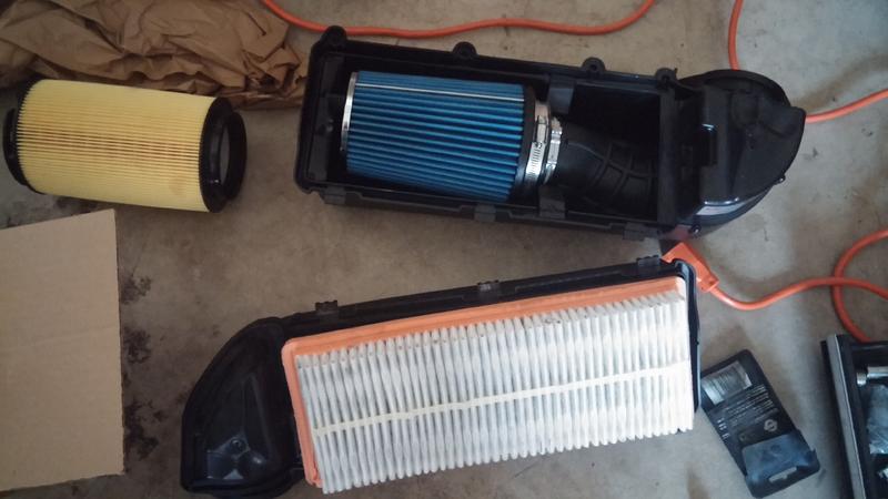

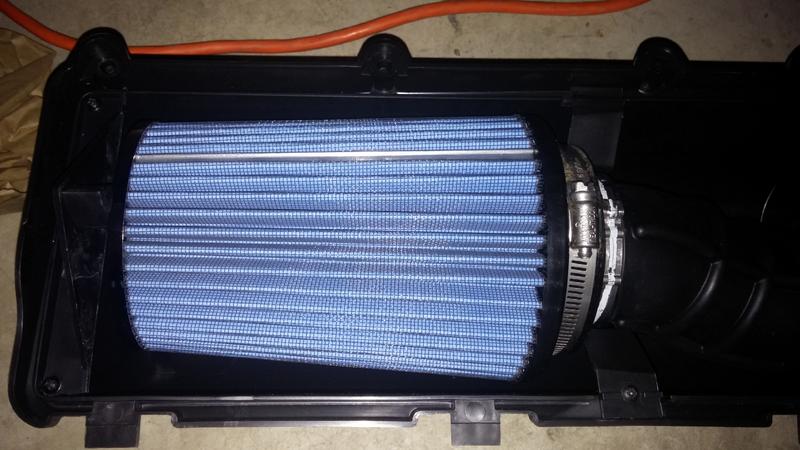

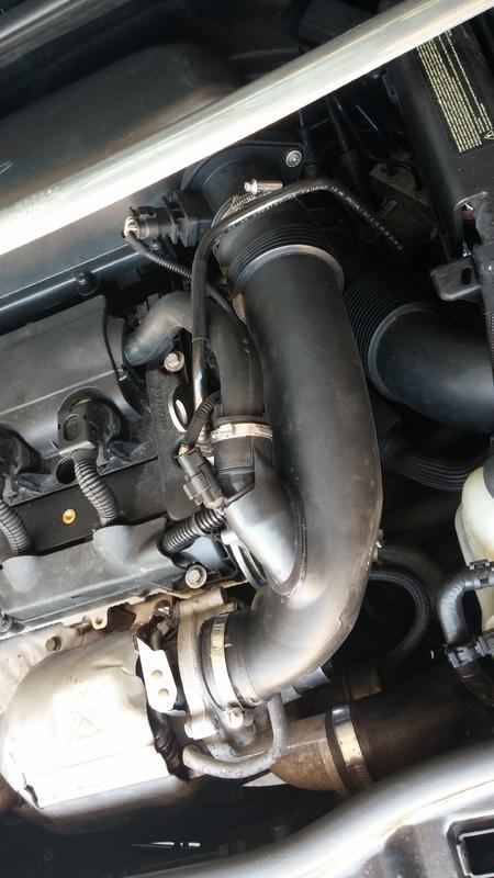

JCW air kit install. It was fairly straight-forward, but if you haven't done one and have the JCW strut bar on it will have to be loosened on one side and disconnected on the other to raise it. Otherwise you might be able to squeeze the old cover out but the new one won't go in with it in place. The AMSoil filter does seem a tad loose as I think I mentioned before but seems to sit ok so long as it's against the bottom triangle mount for the regular JCW filter. I had to take off the screw by where the filter mounts to the rubber hose in the 'lid' and apparently it didn't want to sit in place for the side without a screw when I put it back in. Why that side doesn't have a screw as well I couldn't say. So I put some duct tape over it so I could remove it later to clean the filter. So far the box vibration when the engine's running has stopped.
Attached Thumbnails Aelwulf's MINI-0313151820.jpg   Aelwulf's MINI-0313151820a.jpg   Aelwulf's MINI-0313151821.jpg   Aelwulf's MINI-0313151837b.jpg

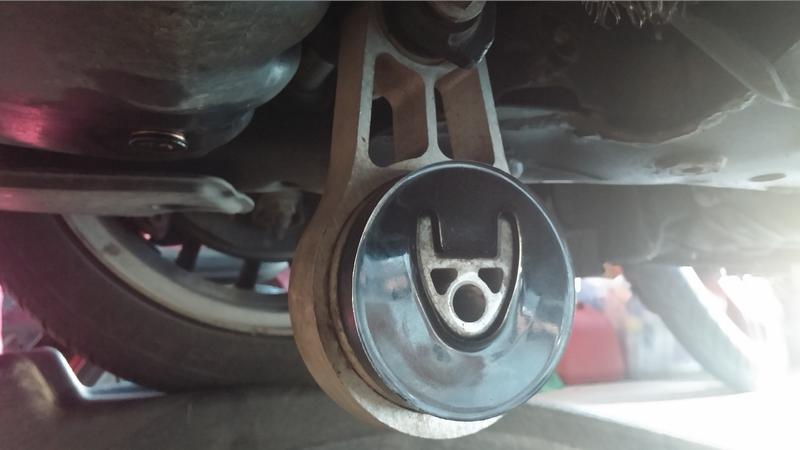

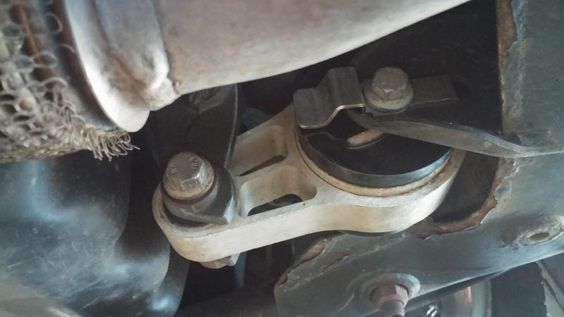

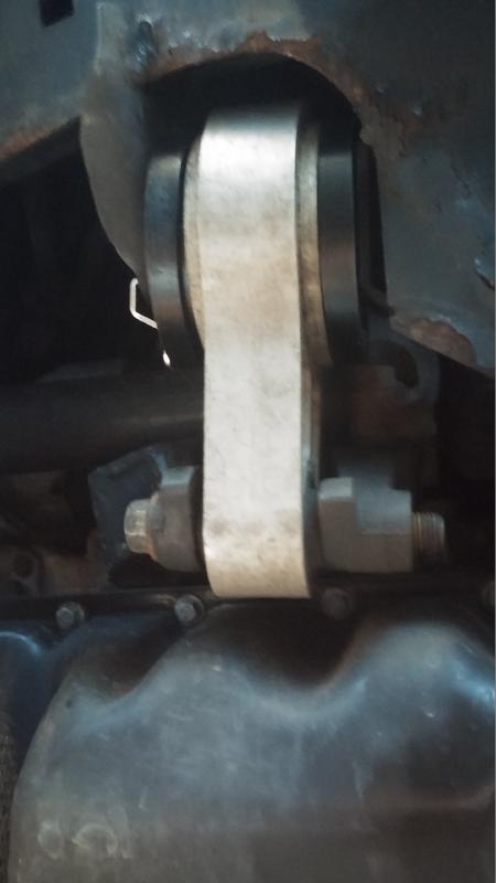

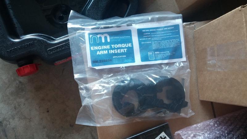

NM Eng torque arm mount install. My bolts were surprisingly clean, just took some grunt pushes to get them moving. I used the ratchet handle to pry it back a little to swing the arm down as needed. To get it swung back into place I pushed a bit on the transmission towards the front of the car and it swung up fairly easily. Doing it this way, and without a 2 year old supervising, it would be a very quick and easy job. I was surprised 1) by their size as I'd never seen a size comparison (I thought they were slightly bigger than a silver dollar) and 2) that it was right behind the oil pan. It was done pretty easily on ramps with the parking brake on and chocks behind the rear wheels.
Attached Thumbnails Aelwulf's MINI-0320151715.jpg   Aelwulf's MINI-0320151716.jpg   Aelwulf's MINI-0320151728.jpg   Aelwulf's MINI-0320151729.jpg   Aelwulf's MINI-0320151734.jpg

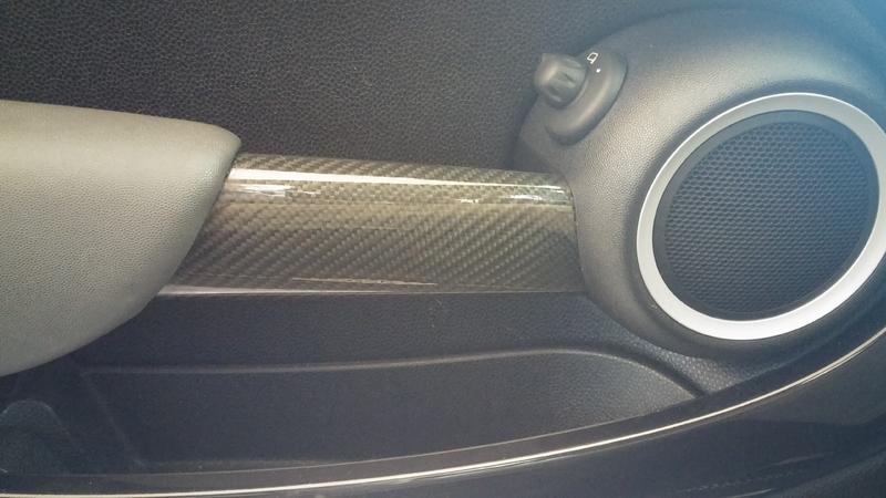

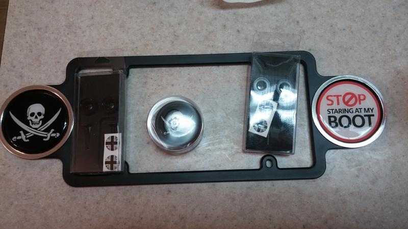

And some of the cosmetic items. Air freshener from GoBadges, grille blackout set in place, and FINALLY getting on the carbon fiber door pulls I bought for it while deployed last November (give or take). Thanks to ra2fanatic for that, I caught a side mention from him in another thread about just pulling the arm pads forward to remove them. I figured out the speaker covers from there.

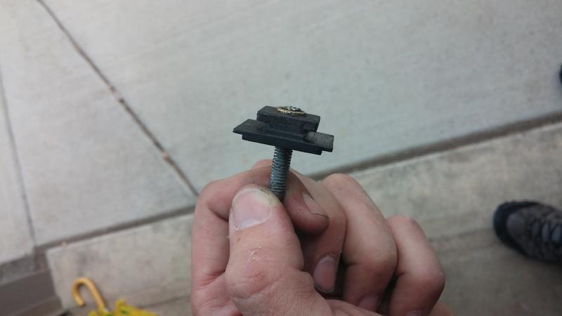

I tried to put on the license plate bolt kit from GoBadges but after taking one of the bolts to Lowe's with an original screw it would seem the bolts are M6 while the screws are M5, so I'll be asking them about that. I bought some silver ones that might work as replacements if needed.
All that's left for this round are the spark plugs (have to order the socket, local MINI place doesn't sell them), install the RSB, receive & install the GFB DV+, and install the headlights I picked up today. I'm hoping to have the latter installed with pics tomorrow.
Edit: Oh yeah, and put on the Light in Sight a bit ago. Takes some getting used to but is definitely handy. Pic added.
Attached Thumbnails Aelwulf's MINI-0320151750.jpg   Aelwulf's MINI-0321150849.jpg   Aelwulf's MINI-0321150850.jpg   Aelwulf's MINI-0310151815.jpg

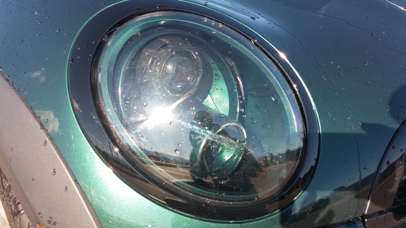

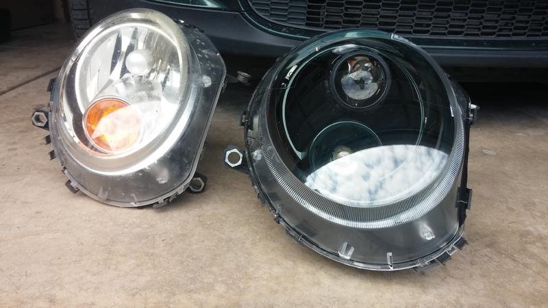

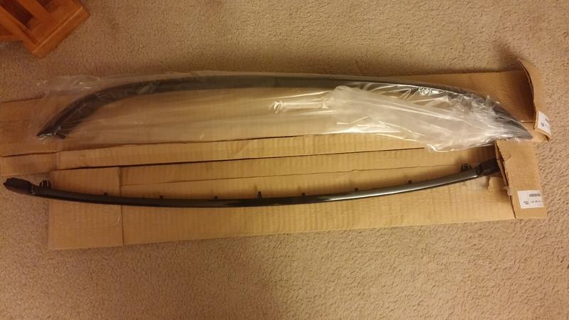

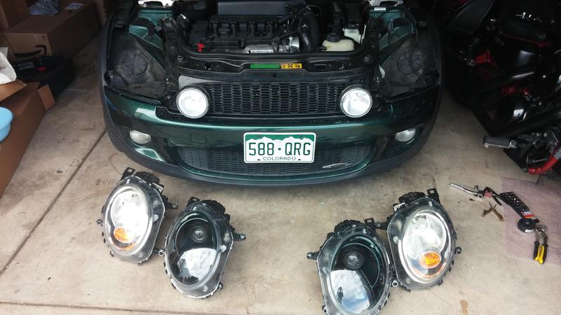

Getting ready for the new headlights! Should've been a 10 minute job. So of course there's an issue. One of the lower outer bolts rusted a bit to the threaded sleeve, which proceeded to break loose from its plastic housing. With nowhere to grip it they just spun together & the bolt couldn't come out. So I had to dremel off the bolt head to get the light off then the other end so I could slide the plastic sleeve housing out. 10 minutes is now half a day plus wait time for replacements. 😛
Attached Thumbnails Aelwulf's MINI-0322151316.jpg   Aelwulf's MINI-0322151317.jpg   Aelwulf's MINI-0322151317a.jpg

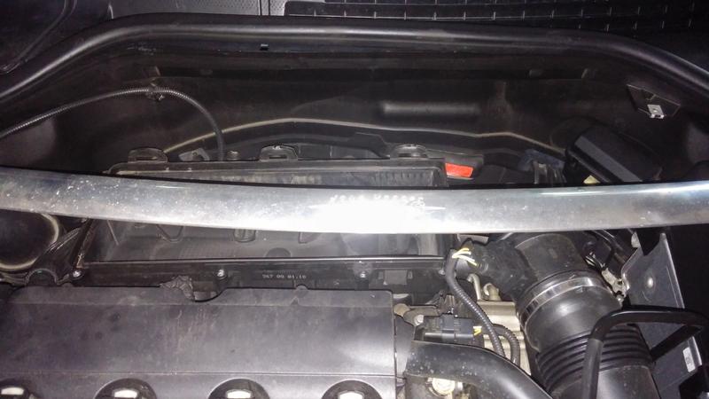

Aelwulf how did you manage to install the JCW intake air box type and the Mini strut tower brace? I've been told you can't fit the aluminum strut tower brace and the JCW intake.
Old Mar 23, 2015 | 08:35 AM
  #83
I've seen this done several times

Didn't do anything special. Car came with brace on it. Wound up just loosening one side & detaching the other to lift it out of the way. Swapped old intake lid for the new & re-attached & tightened the bar. Goes around the intake fine, as evidenced in one of the pics.

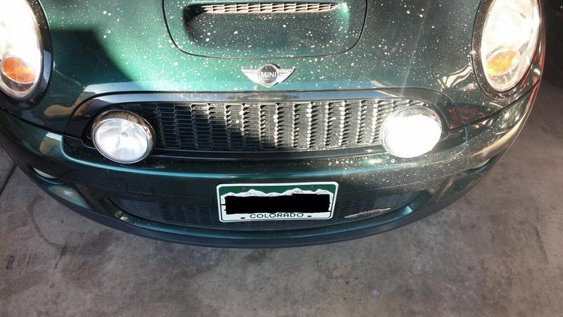

New headlights are also in. They darken the look of the front end a fair bit but brighten up a nice BRG green when the sun hits them, which is also when you can see the MINI & JCW logos in black on the side (one in each). The lights are definitely brighter and working well, just need a slight adjustment.
Carbon fiber license plate posts are on front & back after getting some M5 bolts from Lowe's. After checking GoBadge's site again winds up they do mention that the bolts may not fit, but at the bottom of the page under 'Features' and in relatively small text. They said they'd see about making it more noticeable.

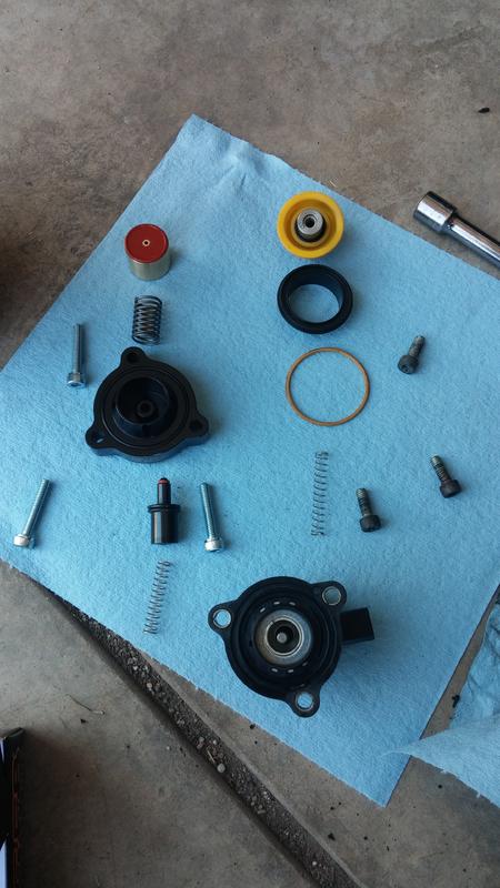

Previous pics of GFB DV+ install and comparison to stock pieces. These are post-install of the headlights.
Attached Thumbnails Aelwulf's MINI-0406151653.jpg   Aelwulf's MINI-0406151654b.jpg

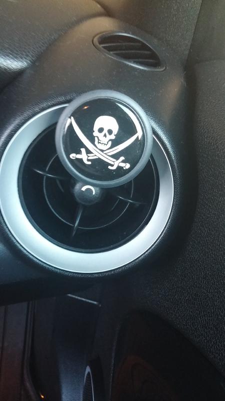

Miscellaneous GoBadges bits (pirate air freshener, black jack glove box button & door pulls). Poorly lit cell phone picture. :p

Originally Posted by Aelwulf
Ok, Brisk plugs are in after some confusion over spark plug socket issues. Ends up it had Denso Iridiums in it which are 6-point 5/8"/16mm rather than 12-point 14mm. Bu the Brisks I put in are the same as the Densos so it wound up being something I'd have had to deal with anyway. Bit of a pickup after, the old plugs looked toasted.
GFB DV+ is in, and in. One of the few swaps so far that went as it was supposed to. no huge difference noted so far but I don't have a lot of actual upgrades yet and don't get many chances to go WOT.
I'm thinking about going mid-range on some coilovers since the ones I want are almost $5k. It'd let me replace the ones on it now that, except for maybe one, probably were on it when it was first sold and still get an upgrade.
The only part I've received that isn't on it yet is the H-Sport Comp RSB, and that's just because I haven't had a chance to get up to the auto shop on the Academy. Once I actually get a few hours on a Saturday I'll see about getting that on.
Aelwulf how did you manage to get a good tight fit with the hard turbo inlet pipe? My turbo inlet port is smaller than what comes with the N18 engines (42mm compresser). As I understand it is the 2007-2010 MCS comes with the smaller turbo inlet port. Correct me if I'm wrong.
Not sure I'd be much help there, as I have a JCW vs an MCS. If memory servers the fJCW has a larger turbo than the MCS of the same year (at least 2009+ anyway). So maybe that's part of it? I didn't have any issues with fit on the pipes that I noticed. And mine's an N14 so if you have the same and are using something off an N18 there might be fitment issues. I haven't seen an N18 yet though so couldn't say.

How are the headlights working for you? Any bulb out errors? And, if you don't mind me asking, how much did they cost and who did you have do them?
Old Apr 27, 2015 | 04:54 PM
  #91
Aelwulf's Avatar
Aelwulf
Joined: Aug 2014
Posts: 294
From: Colorado Springs, CO
Headlights are working great. They're only off adjustment by a small amount, not enough to worry about so I'll fix it when I get time one evening. I had one day where one didn't turn on at first when I started the car, but turned it off and back on and no issues since. If it were to become an issue I'd just contact the guys who did it and they'd check it out. No errors inside, they're plug & play with no lights or anything. They also have both high & low beams, unlike some aftermarket ones where you lose the high beams.
I had it done by Black Flame Customs up by Ft Collins in Colorado. They were $1,050.00. $300+ of that was the housings, they use OEM housings to ensure it fits. That was also an option I chose as I still needed to drive the car while they were doing the lights, so have spares if needed as well. I also chose to have them painted with amber delete turn signals and the plug & play custom HID conversion upgrade kit. They knocked a bit off for both military discount and for paying in cash at pickup.
So I'd guess if you had them use your current housings and just did the HID conversion it'd be somewhere between $500-700?
And yeah, I could've used the money on actual performance parts but I wanted something to help make it unique that would also be an actual upgrade.

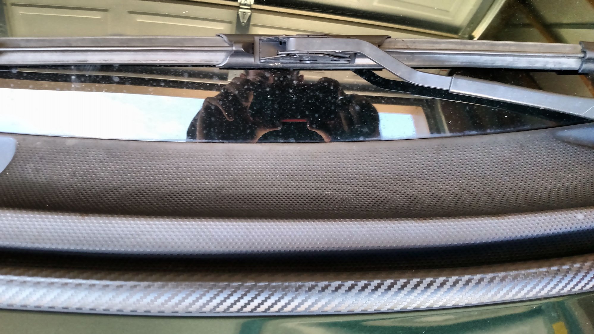

I found some carbon fiber patterned tape I'm going to try and do the trim with. I have tape to black it out but wanted something different and I saw another post where someone did this and it looked pretty decent. So we'll see. I'm hoping to get that and a couple stickers added for fun tomorrow if time and family permits.

Beltline blackout done. I had a roll of black tape, but saw an instance of using carbon fiber tape. So used that instead.
I like that look. Where did you get the carbon fiber tape? I might do that to mine.

Think it was O'Reilly's. There or Autozone. It's in the striping/tape section. Easy to find, but each store in town only had one in stock. A roll is about $12, but should have more than enough for a beltline.

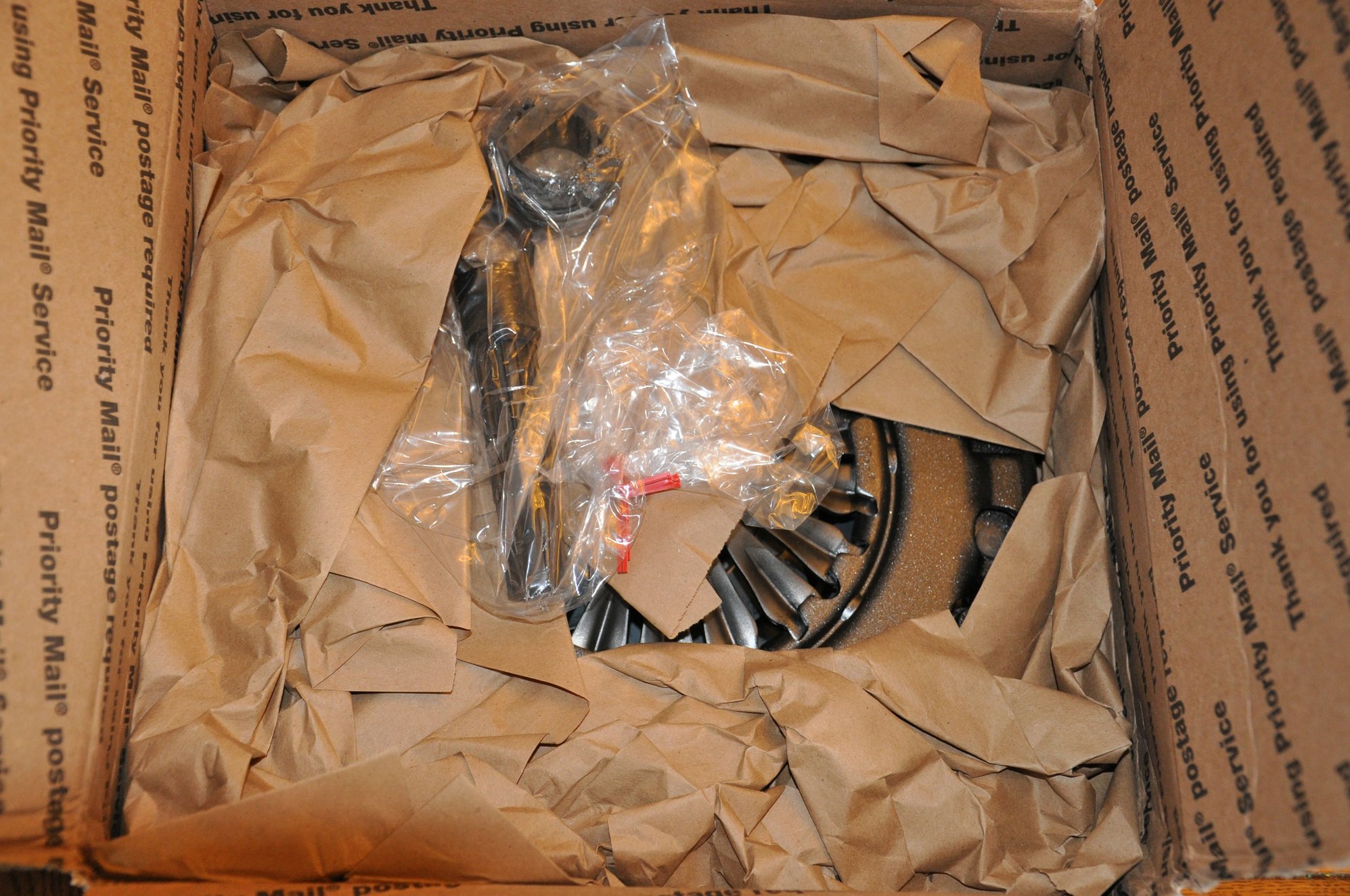

Pics of the clutch bits below. The clutch came assembled and I was on the clock to get it to the shop so didn't take it apart, and forgot to get one of the back with the flywheel. Sorry. :/
So far the pedal is definitely lighter/easier than it was, and grabs a lot quicker than it used to.
Installation kit. This punched a hole in the side of the box, but nothing was damaged. Arric said he'll start putting more packing in it.
