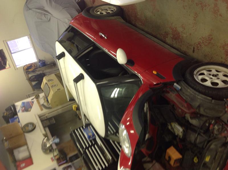

I bought a 2003 Mini for my GF to drive when she's up here in the great white north. The previous owner stated it had a bad starter. With the key in the ignition and turned to start (or on) everything works, but the car would not turn over. I noticed that the key will not lock or unlock the doors but the back hatch does lock and unlock and the park lights light up when the button on the key is pressed.
I replaced the starter tonight, and upon trying to start the car....nothing. I still had the heat shield off of the starter so I jumped the solenoid to the starter with the key on. The car fired immediately and ran/drove great...... with the exception of a thump in the passenger CV joint (that will be a separate thread....lol).
I checked the battery in the key and the voltage checked out fine. I'm thinking there was nothing wrong with the starter, and I actually have an issue with the theft deterrent system?
Any advice would be greatly appreciated.
Thanks in advance.
Allan
