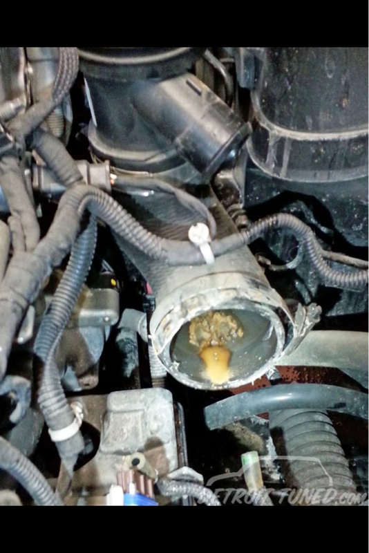

I would love to know how it's bad for the environment? And you should ask the real mechanics that work on MINIs if it's so bad to let the car warm up in 0 degree weather and -18 degrees wind chill. Enjoy the frozen ice in your intake, if you live in the Midwest. Is it really worth it? Yes, I'm not gonna spend $300+ to fix it.

2.) Even though the carburator and choke gave way to EFI, the way engines start when cold hasn't changed. The mixture has to be really rich. EFI engines use a cold start enrichment loop to take care of this. The downside is that cold start emissions are grossly bad, with lots of unburned hydrocarbons. Thus bad for the environment. Manufacturers try very hard to reduce emissions. They use secondary air pumps to get the catalytic converters to light off. And want you to start driving to put some load on the engine to produce heat. Letting it idle really doesn't do that. It takes much longer to heat up when letting it idle than by driving.

1) check out the picture. That's water that turned into ice in the intake path.

1.) If you have standing water in the intake track, you have other problems.

1) this is a known Mini issue.
https://www.facebook.com/photo.php?f...type=1&theater
https://www.northamericanmotoring.co...-manifold.html
