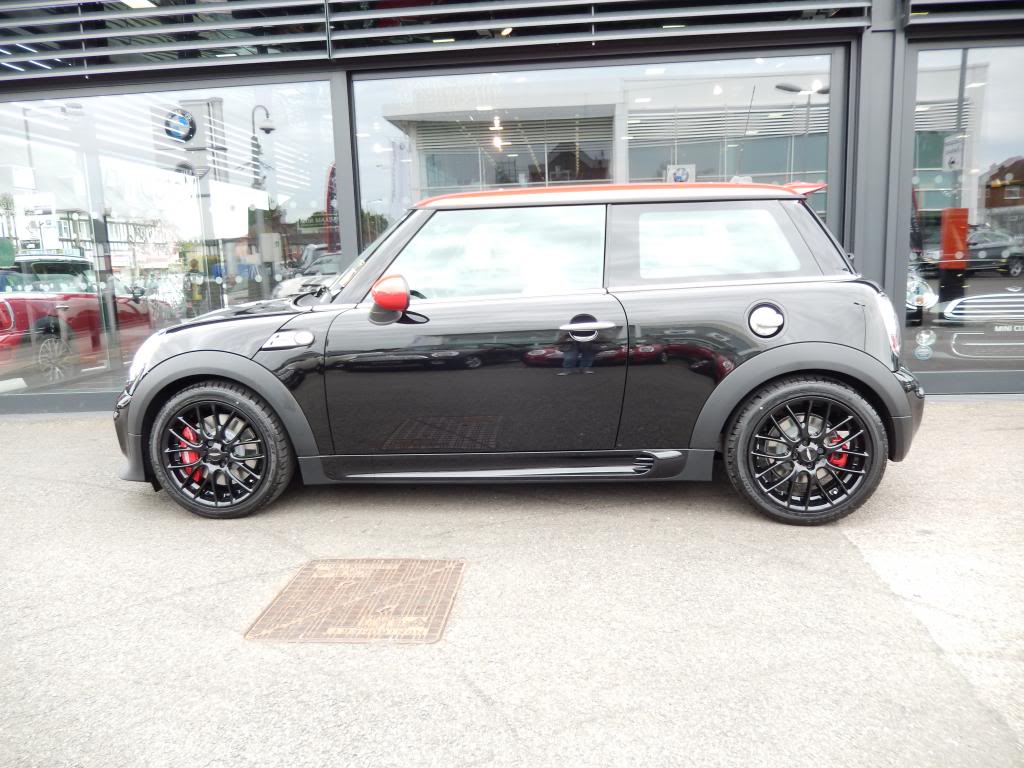

Hey Charlie, Thanks for the post! As i am new i think it takes a little longer to get my pictures approved by the admin team. I have tried uploading some pics let me know if you can see them. I have been going with option 2 quite a bit From your experience does the sport button do much apart improve the response and tighten the steering wheel? [IMG][/IMG]
