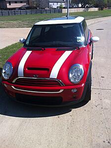

Really appreciate everyone's response! Thanks for helping me get familiar with me new mini! Here's a picture of the yet un-named mini! Maintenance and Supercharger-ht4agjg.jpg
