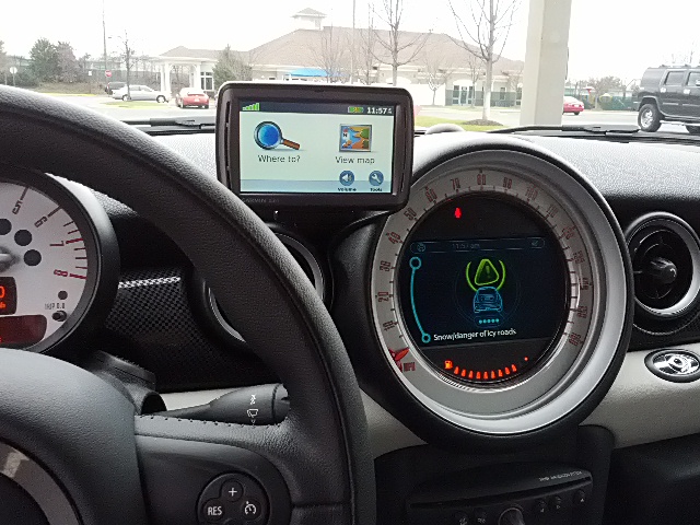

Here are the photos of the Kuda mount in the Roadster. Yep, I have Navigation option in the Roadster (spec'd by the Dealer) and I tried using it the first couple of weeks, but was so accustomed to my Garmin and how I can upgrade/load POI, etc on it) so I have both.
Anyway, here are the photos. Some of them include the GPS mounted, the others, I removed it so you can see how the mount attaches. Hope this helps!
Originally Posted by spiney
I have a Proclip but I might swap for one of these. Can you post a picture of it in your car? How easy was it to install in the Roadster?
Attached Thumbnails Alternate GPS mountings-img_20130121_115756.jpg   Alternate GPS mountings-img_20130121_115832.jpg   Alternate GPS mountings-img_20130121_115910.jpg

Wearlaz, thanks for sharing pics of the Kuda mounts - btw, nice install (wiring etc)
I went the Craven route which ok, but I like the looks of the Kuda set up...

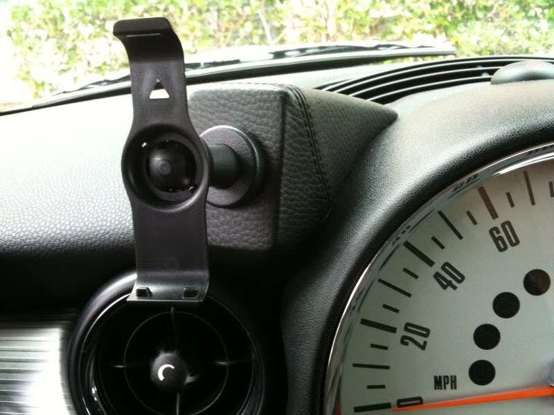

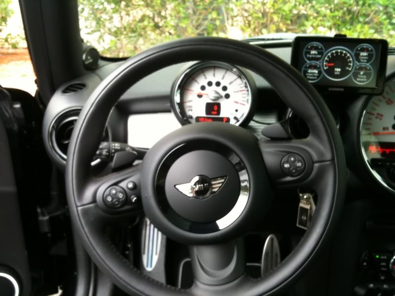

i also highly recommend the kuda mount over the cravenspeed mount. i've used both but didn't care for the craven mount after about a month of use.
the cravenspeed mount is simple to install and looks good, but the biggest problem with the mount is that your gps unit will bounce. you just can't stick a gps unit on the end of a 5" extended arm and expect it to not move. physics don't work like that.
the kuda mount is a bit more difficult to install, but it's solid, nothing moves, and it looks really good.
here are the instructions i pieced together from a few install write-ups i've seen. don't bother with the kuda instructions. these are for a 2012 R56, but i'd imagine they aren't very different from other models.
1. remove the tach
2. remove the dash trim (it should pop right out with a good tug)
3. remove the 2 screws around the vent near the speedometer, one is to the bottom right and the other is on the upper left of the vent (T-20 screws)
4. there should now be enough give to lift the speedo housing up a bit and expose a little bit of a gap near the front of the dash.
5. put the kuda mount on its side so you can slide the tab on right side under the gap in speedo housing near the front of the dash.
6. after sliding the tab under the housing, rotate the mount counterclockwise so the tab is "locked" under the speedo housing and slide the mount back (towards the windshield)
7. push down on the a/c vent to create a small gap and slide the second tab under the dash
8. put the screws back around the air vent, snap the dash trim back on, reinstall the tach
here it is. gps stays close enough to your line of sight, but does not obstruct any of the windshield.
Attached Thumbnails Alternate GPS mountings-786219ae.jpg   Alternate GPS mountings-12a51f50.jpg

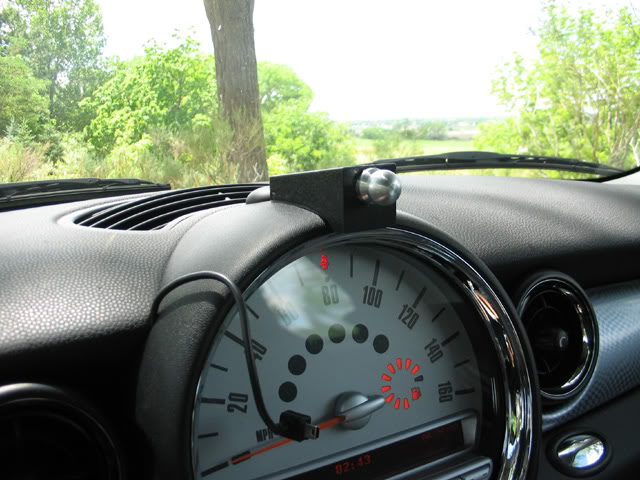

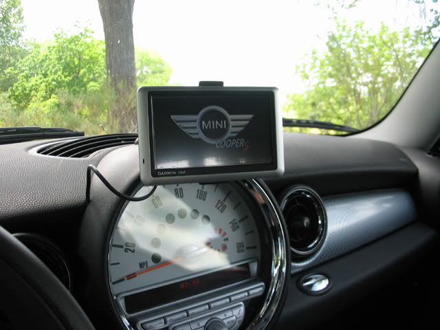

If you're handy with the tools, here's something...
Both the passenger and the driver can see it very easily!
Photo 1:
The mount was machined from a piece of solid aluminum to match the contour of the Mini's speedometer. A ball was made to fit a typical Garmin mount.
Photo 2:
The mount painted and then installed with double sided tape.
Photo 3:
GPS Unit installed.
