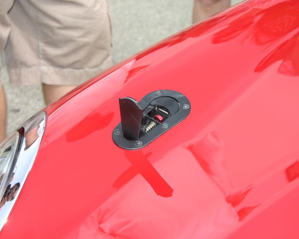

Get these
http://www.aerocatch.com/
Clean safe and they lock

Originally Posted by Porthos
Get these
And apparently the R56 challenge cars use them. I happened across this trying to find a close up of how the Jeep style ones mount to the bumper:

Thanks, they're the Drag DR-20. I did think about the Aerocatch but the straps were much cheaper. Now I'm wondering if maybe I should just do it right the first time. Just a little weary of cutting the much bigger hole needed for Aerocatch.

Do it right the first time. It will look better and the fact that you can lock them is awesome!
