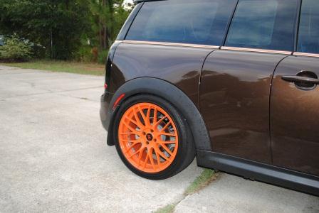

Hi Octaneguy, We are new to MINI so have a lot to learn. Recently picked up a used 2011 Clubman S. Has 225/40R18 tires and Ti Rims. Tires are rubbing in the back with over 2 people in car and no one seems to understand why. I'm thinking the wheels / tires are too big? But they are too nice and expensive to swap out now. I saw on your post about lowering the height of car? Do you think it's possible the previous owner did that? Is there a lift kit available to raise the car a bit? No Mini dealerships nearby so we are trying to learn on our own. Love the car but if you could share some advice on the tire rub issue I'd appreciate it!! Will post picks later. Thanks!!

Congrats on your new MINI! My rims are 42 offset and 17" and have no clearance with 225's. On my recent trip to Colorado, my Clubbie was fully loaded with 3 passengers, bags, and inventory for the MITM event and I didn't rub even though I was below the fender line and I'm on coilovers unlike the year before when I was on 225's and my 2,000 mile drive was miserable!
When I look at my old pix from a year ago, my 225's were really too big for the Clubbie..so I can imagine what yours looks like on 18's.
You don't want to raise your suspension for "looks" to sacrifice performance.
Keep your 18's but go to 215's and you should have better results...what is the width of your wheels? 7 or 7.5" or 8"?

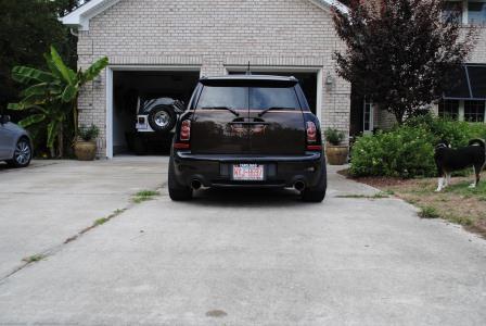

OctaneGuy, Thanks so much for the quick response. I measured the wheels and they are actually 9" wide, so that may be the problem. Leaving as is, and with it not rubbing all of the time, but sometimes, will that really tear everything up in your opinion? Tires are still in really good shape so I hate to ditch them now for 215's.
I'm attaching some pics so you can see. Besides the tires issue, we are really loving it! Thanks!

Did you measure the wheels themselves (across the barrel) or the width of the wheels and tire? If it hasn't happened already, the carpet wheel well tire lining will be torn to shreds and check your sidewalls. When I was rubbing, the shoulder and sidewall were literally getting shaved off. There are others here on this forum such as Rally@StanceDesign who are running on 9in wide wheels and airbags for that slammed look...they know more about this than I do.

Hey Rich,
I don't think I would rely on that measurement. Maybe he should remove one of the wheels from the car and look around the inside surfaces of the wheel casting for the size. Most wheel manufacturers cast or stamp the size of the wheel right into the casting. BTW, I seriously doubt he has a 18x9, more likely 18x8.
Just my 2¢! Good Luck

Good idea, 2 cents is better than no sense. I'll pull a wheel and look for stamp. Odd, but we're loving the orange and would love to make it work. Thanks
