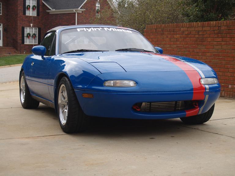

Thanks Charlie! I've run several events in the last two years, but with constant building and class changes on my 90 Miata. I never intended on being real competitive for time reasons and really just do it for fun. I am going to my first track day at Road Atlanta with NASA in two weeks and hope to become addicted to that as well. As for the Mini I have a spent set of tires on the stock 17's that I will put on for the weekend auto-x and just run stock class. That way I can save the big tires for the track. You knowledge is envied and appreciated. Here is my Miata, turbo'd with Ohlins suspension ect. Ken
