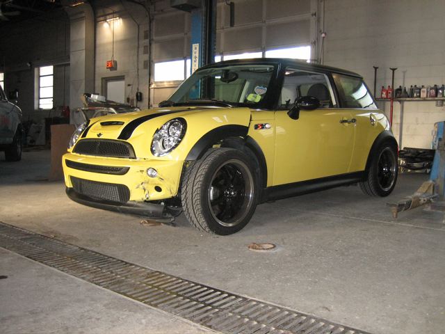

Last night a girl made an illegal left and drilled my MINI. It's in the shop now and needs a hood, bumper, etc. The airbag blew also.
My biggest concern is that it won't start. I looked in the manual, but I can't find anything about this.

I'll be doing the repairs myself. I just hope I don't have any hassle from the insurance company. I'm not putting aftermarket parts on my 12000 mile car.

The airbag was more of a pain in the *** than anything. She made a left in front of me and I tried to make a hard right and swing the back of the car around to miss her. When the bag blew. It threw my hands off the wheel and it was all over. The bag is full of powder to keep it from sticking to it's self when it's folded. The powder blew all over and it looked like a smoky mess. The four way flashers came on an the windows rolled down.
Thanks, I like the wheels too, luckily none were damaged.
I was able to push start the MINI and drive it around. I think the fusible link by the battery needs to be replaced. It runs and drives fine, so now I just need to get started on the repairs.

As for the car not starting after the airbag deploys, it blows out the positive battery cable. The little black box onthe cable houses the pyrotechnic device. $250 for the cable and some labor get it back running.
Airbags deploy based on how fast you come to a stop, not how hard you hit, or what you hit.
Right now the estimate is at $7500.00.

The repairs have began. I changed out the battery cable tonight and got it running. The cable is about 17 feet long and a pain in the *** to change.

Frame is straight again and the new cradle is in. I'll get the parts tomorrow and start putting things back together.
