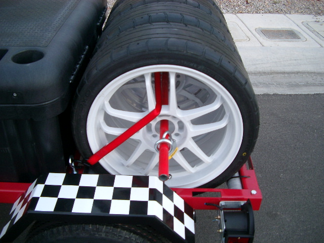

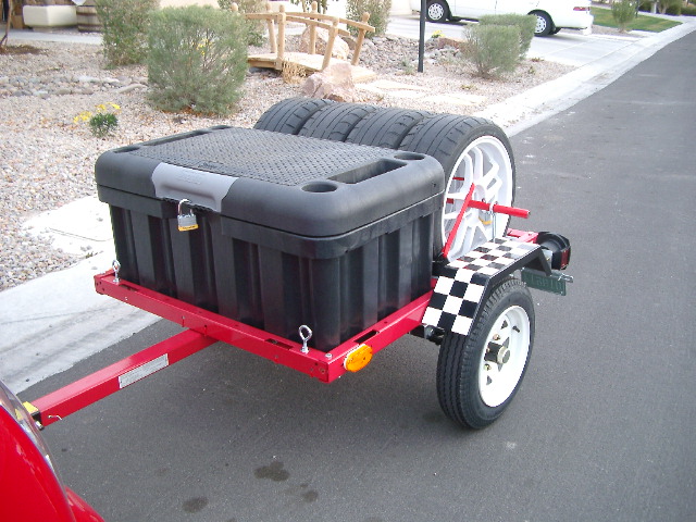

I took my time with this and think I have a what I wanted. After searching for the right set-up I decided to go with this. Crash Karl hitch and a Harbor Frieght trailer. Bought the trailer on-line and had it shipped to the house for under $250. Assembled it and paid close attention to the wiring as most problems with a trailer are wiring or bearings. After many hours measuring and plotting the size of the tires and tool box I came up with this configuration. I bought the tool box at Walmart for under $50 and a Hoppy Converter for the wiring at Pepboys for about $28. The tool box fit perfectly in the front of the trailer with about a half inch between it and the set of tires. I bought some dexion and bolted it to the middle frame for the aft cavity and tip tied two pieces of heavy duty PVC pipe for the tires to rest on. The wiring harness was installed and routed through the rear vent by the back latch assembly and routed between the aluminum bumper and down to the hitch. Driving behind the car is a breeze with with no problems up to 75 MPH.
