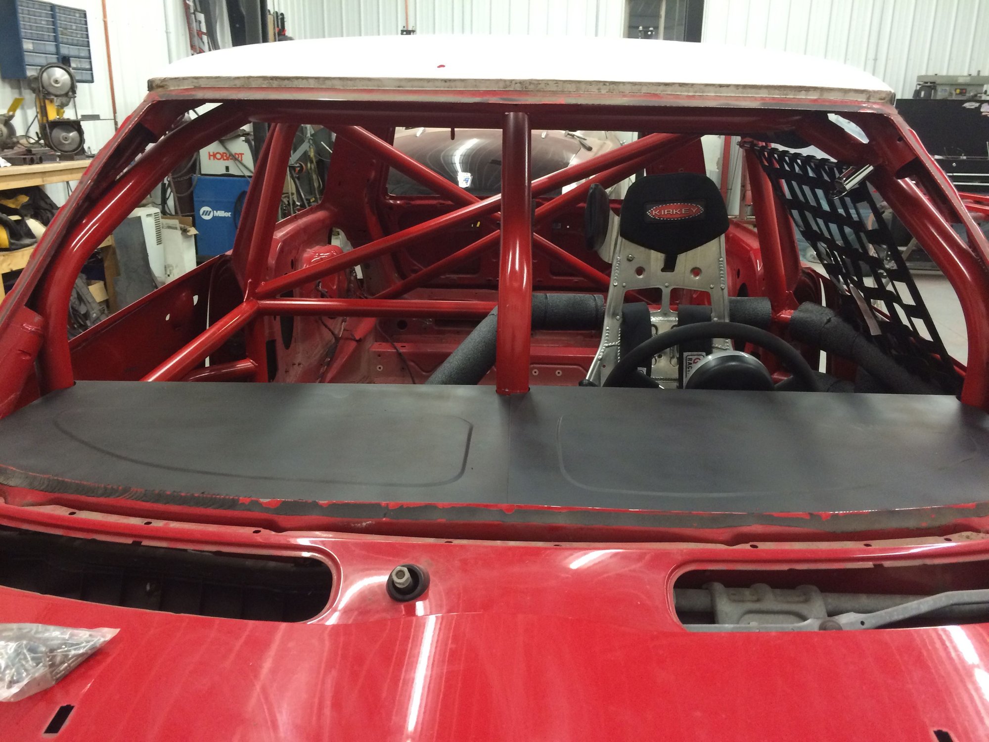

Old Jan 9, 2018 | 08:24 PM
Tudorfritz's Avatar
Tudorfritz
Joined: Oct 2017
Posts: 24
Old Jan 10, 2018 | 06:25 AM
Dirt Oval Racer's Avatar
Dirt Oval Racer
Joined: Nov 2017
Posts: 14
From: Holstein, IA
Wow!, That's some good looking work done on that. Nice job!
