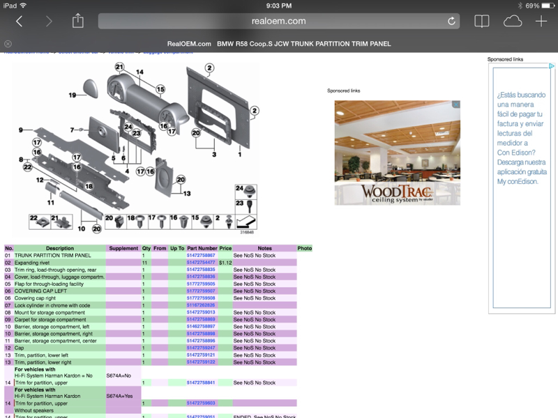

Great. Let me know. I'm prepping for next season and need this. I'm not partial to the 2 pads In the humps that appear removable. I'm guessing I could save almost an inch if not more and then make in insert to replace the 2 pads.
I'm talking about #19 I the pic
It could also leave me room to wrap the belts around the bar and let them lay flat when street driving
In any case I'll see what your guy has or I'll just make my own as I am able to have some one weld them for me once I get the material. I priced out the tube it's like 60 bucks all I need is the 2 brackets for the seat belt mount.
