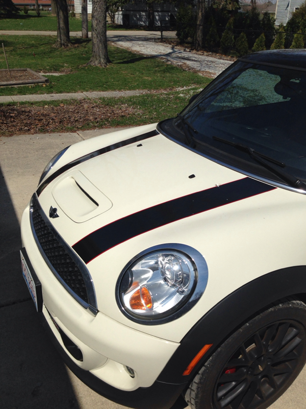

The biggest reason I was thinking of trading my 2011 JCW hardtop for a GP2 is because I like the way the GP2's exhaust sounds! I may need meds!!! Can someone PLEASE, PLEASE tell me what I can do to get my exhaust to sound like the GP2's? I have some pop 'n gurgle, but I want more. I took it to Mini and had them update the computer and that did zilch.
Of course, I do have other reasons for wanting the GP2, like the seats and cool color-but it really isn't THAT much faster than mine. And seriously people, how fast can ya go anyway? There are speed limits ya know.
Any suggestions would be greatly appreciated! My husband will be thanking you.
