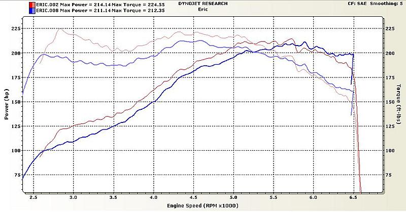

THE PROOF IS IN THE PUDDING!!
Dyno results attached from pulls I just made yesterday.
Red lines: STOCK from 6 months back (Before mods or dealer reflash) SGII showed 20.5psi
Blue lines: MODIFIED (Forge FMIC, Craven filter, Turbo muffler charge pipe, Turbo noise maker delete, and finally a custom 2.5" Turbo back Catless exhaust pipe) - And oh yea... a shiesty DEALER REFLASH!! SGII showing 15.5 PSI on the Dyno
Just look at the numbers. Blue line still 10-25 HP below what it was when STOCK!!! With the supporting Mods I should be at least more than it was when stock.
I almost swear now that the dealer flashed my car with a Cooper S map. In a few days my tuner will be able to tell me more about that.
DO NOT GET YOUR CAR REFLASHED!!!! If you do you will be sorry!
Do you have an 2007 R56 MCS? I think 08s and later would already have some restriction to the boost to specifications. The boost is supposed to be about 0.8 bar which is about 15 psi.
It can be a little difficult to compare before and after with 6 months time in between. Also SG II does not show you the max boost, only the boost at an instance in time. But it is not continuous reading but polled. Even with the fast polling rate, there is still a lag between readings.

I have a 2009 Factory JCW. The SGII may lie, but the dyno does not. Listen to what people are saying in this thread, and then take another look at the dyno sheet.
I feel shafted

Then you should have 1.2 bar boost but you are getting 0.8 bar.
It can also be the stuff you have put on or some leak somewhere. Not all mods play well together or add HP as claimed.
This however is not the case. I noticed the a night and day difference the day before versus the day after dealer reflashed my car. Not only that, but before the reflash I was already running most of the mods with positive results (Search for Forge FMIC thread started by me to find dyno sheets).
Theres no excuse for the dealer's 'abuse' of their programming power.
