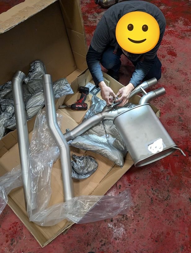

This post is mainly for informational purposes for anyone considering a REMUS cat-back exhaust for their MCS. I have a 2024 F56 Mini Cooper S (LCI 2) and I just had the exhaust installed.
On REMUS’ website, there are a few different versions to choose from. There are some that specifically say “Not for Facelift up from 03/2018!”. Despite that disclaimer, the exhaust fits perfectly. These versions are also cheaper than the ones advertised specifically for the LCI 1 and LCI 2 models.
I couldn’t find much information online about this, so hopefully this post helps others in the future who might be wondering whether the “Not for Facelift up from 03/2018!” REMUS exhausts will fit their facelift F56 MCS
The one I bought is the non-resonated version with SKU # 756215 397

The LCI version has a V-band connection on US & European cars.
This Remus exhaust has a lot of drone sound below 2000prm.
Not for me, after one week using this exhaust i put back the oem exhaust with stright pipe.
The oem exhaust with stright pipe give more sound and no drone at all than the remus.

I've noticed with the valve fully opened, there is some drone noises in the cabin at speeds higher than ~90KM (50Miles)/hr. I didn't purchase the actuator controller but I'd imagine the drone would be much less (or non-existent) with the valve closed.
