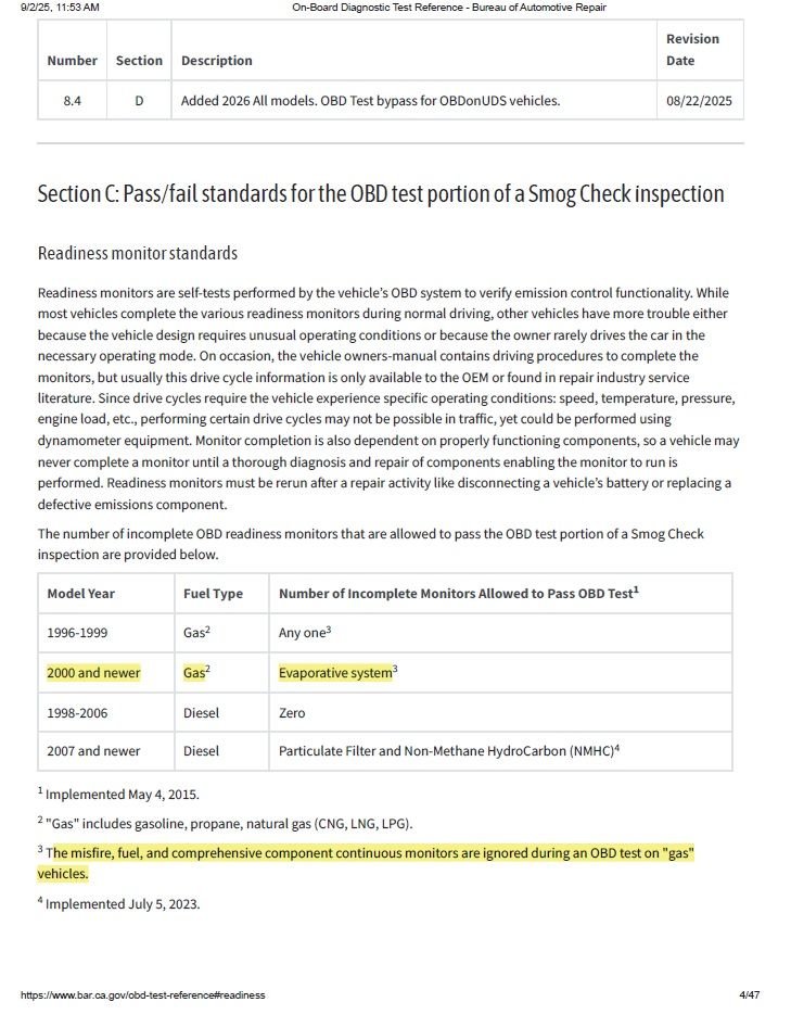

I managed to fix the timing cover leak over the weekend and did another smoke test. No leaks present. I recorded the "since DTC Cleared" pictured below as all monitors have passed "except" fuel monitor. When I first had this issue back in April, I immediately contacted my Smog guy and he said that it would "NOT" pass because of this. I even crossed checked with a few other stations, and they said the same thing. Again, since then, I have drive over 2000 miles, a bulk of it traveling on the freeway as well as all the Drive cycles. I did manage to look up the CA "BAR" website on this monitor and came up with the following attached below as well. I just wanted to make sure I was not wasting time and money on an issue that needs further fixing to pass. But at this point, I am all ears...

​​​​​​​"Just wanted to provide some information on this topic as it does not seem like it was resolved. The OP is from CA. In CA you actually do not need to have the fuel monitor completed to pass a CA smog check. It is not mentioned often because this is such a rare occurrence but the continuous monitors are ignored during a CA smog check. See section C footnote 3 in the link below."
I'm not going to play legal here, but if you are in California, it seems someone else came to exactly the same basic "does actually it matter to pass the emissions test" question for that state that you did.
