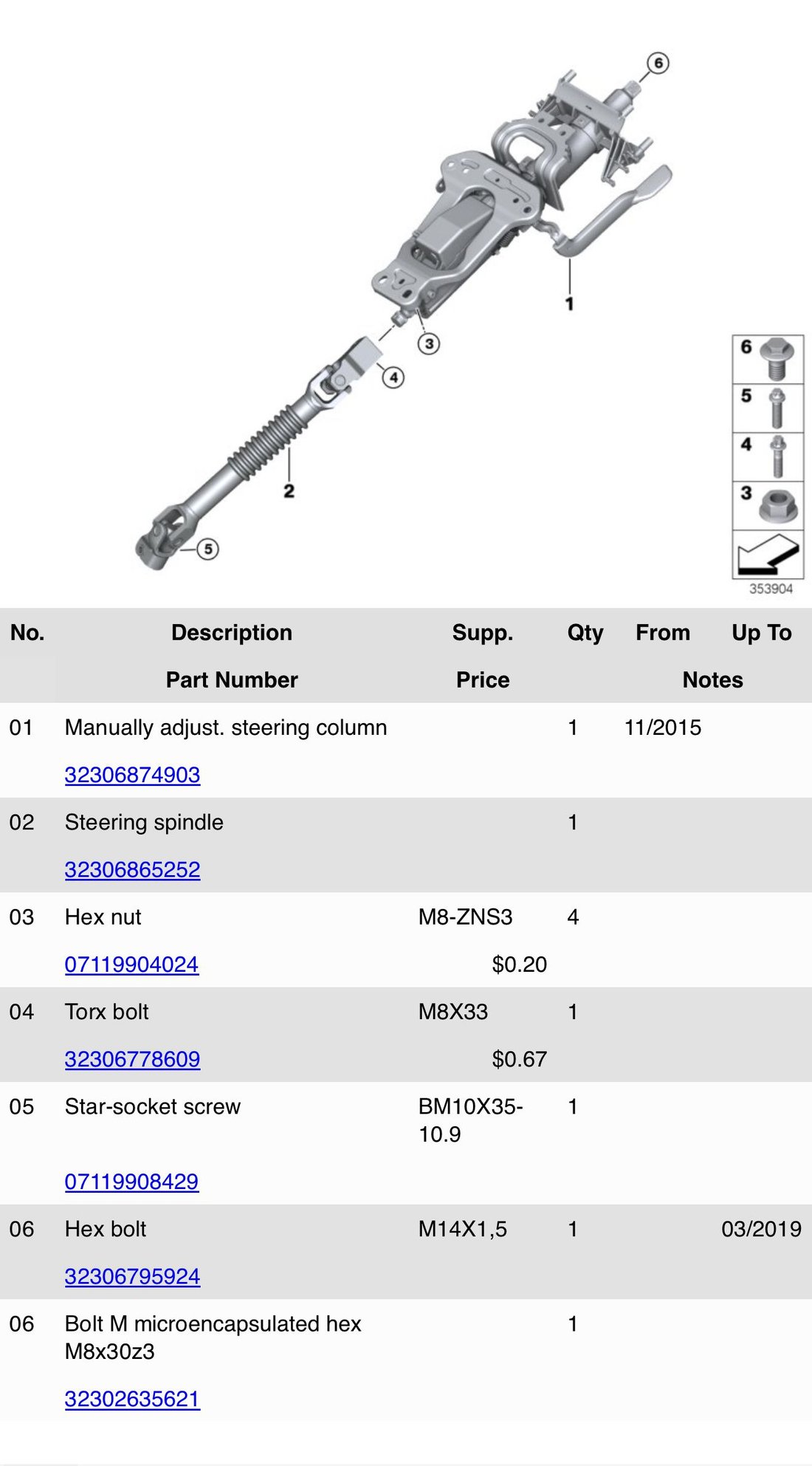

Hoping to tap the collective knowledge base with respect to steering column torque specs.
2018 F56
Trying to locate (image attached)
-steering wheel nut torque #6
-steering column nut(s) torque #3
-steering column torx bolt #4
I have the Bentley manual, unfortunately it lists torque for Gen 2 (awesome for my R58) but I’m now working on the F56 and those values appear to be rather elusive.
2012 R58 steering column torque values
46 ft/lbs steering wheel nut torque #6.
26 ft/lbs steering column nut(s) torque #3
21 ft/lbs steering column torx bolt #4
can anyone confirm it they’re the same?
