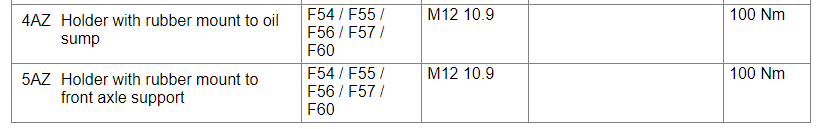

@2014MCS_Miami here are the torque specs for the upper engine mount. Note the engine mount to cylinder block also calls for a 90-degree turn after hitting torque, as these are torque-to-yield aka TTY aka stretch bolts (hence the instruction not to reuse). Also note the engine mount to body (side member) bolts are also TTY but the torque is way high by comparison (pretty close to lug nut torque in fact).
If you want torque specs for the other mounts just give a shout. Nice writeup

Lower mount (the "dogbone" mount):
Transmission mount:
Source is BMW TIS.
