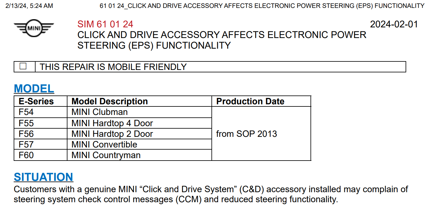

Yep, I had this issue. Short version is that if you wire the Click & Drive exactly as the BMW/MINI instructions tell the dealer to, you can end up with this. Electrically disconnecting the Click and Drive’s in-cable USB charger and then clearing any unhappy codes will get you your power steering back, and reliably so.
Longer version is at the link @TVPostSound provided — I authored the post the link goes to.
There are other ways to wire up the Click & Drive to do what one wants. But the by-the-included-instructions way is bad. I disconnected mine mid-circuit to keep it from causing any shenanigans (see the post for details - I did not disconnect any wire splices, because one spliced wire is a fragile and critical computer feed) while I decide how to rewire it.
@Mr. Squeak , I would recommend having them show you & document how they wired it in (meaning which wire to what pin number on what connector number). There are only 2 wires, so this should be easy enough for them to do for you. Even if they rewired it and got things working more normally, it’s information you’ll definitely want to have and keep.
