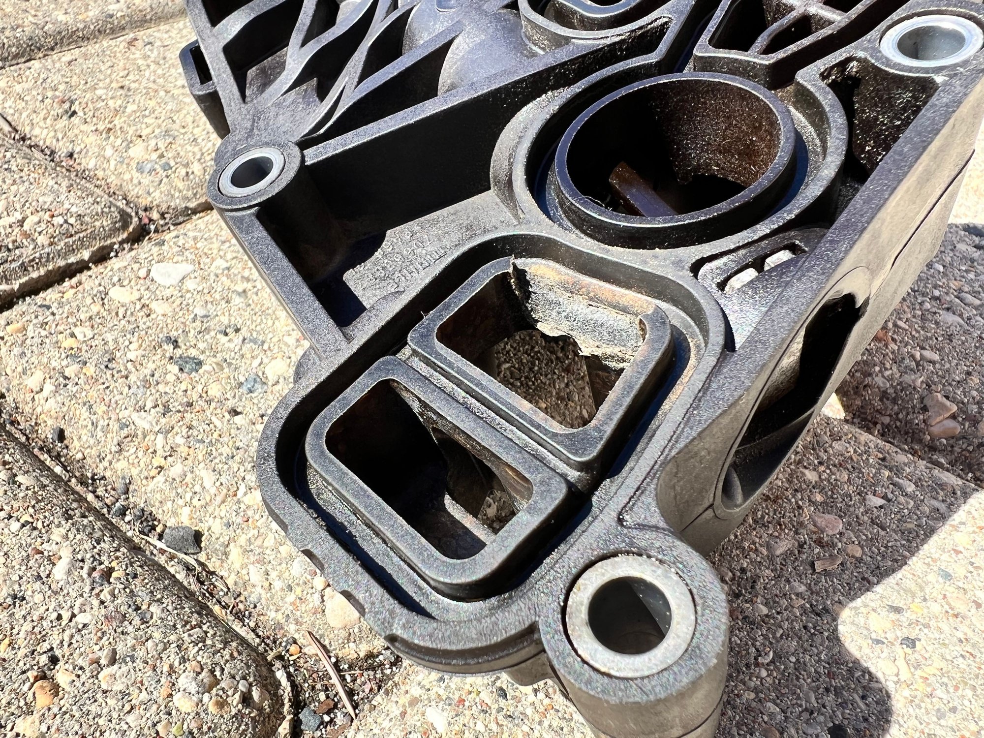

Originally Posted by cjv2
Heads up: something I missed when I replaced my oil filter housing. BMW instructs you to prime the engine oil before first startup after doing this repair. See this thread for details (and a link to a PDF with instructions).
Good call. 👍 I pulled my fuel pump fuses and cranked it to prime mine.
A close up picture of the spot that fails if anyone is interested.
Old Apr 5, 2024 | 01:27 PM
  #55
Posts: 36,758
Likes: 2,548
Yep its like the fibrous plastic really degrades and gets brittle.

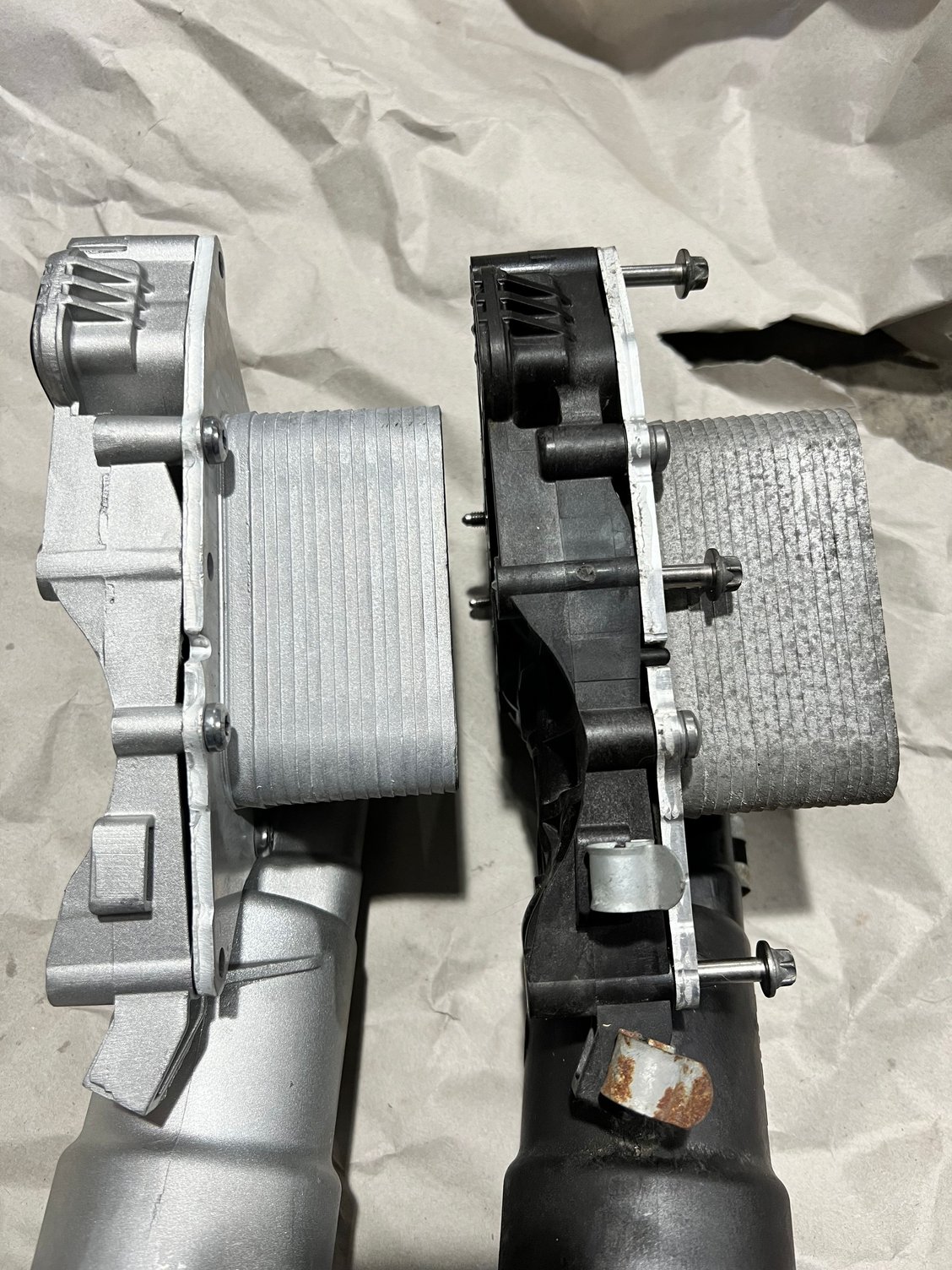

An update. I did the thing with the metal version of the filter housing and cooler. All is well. You could take any of those pictures of the typical break near the one port and that is exactly what mine looked like as well. The only thing that didn't go well is that the intake gaskets I got off the jungle website didn't fit... though they were confirmed fit. Sigh. So I put it back together with the old squished gaskets. But thanks for the help. this thread was very helpful.

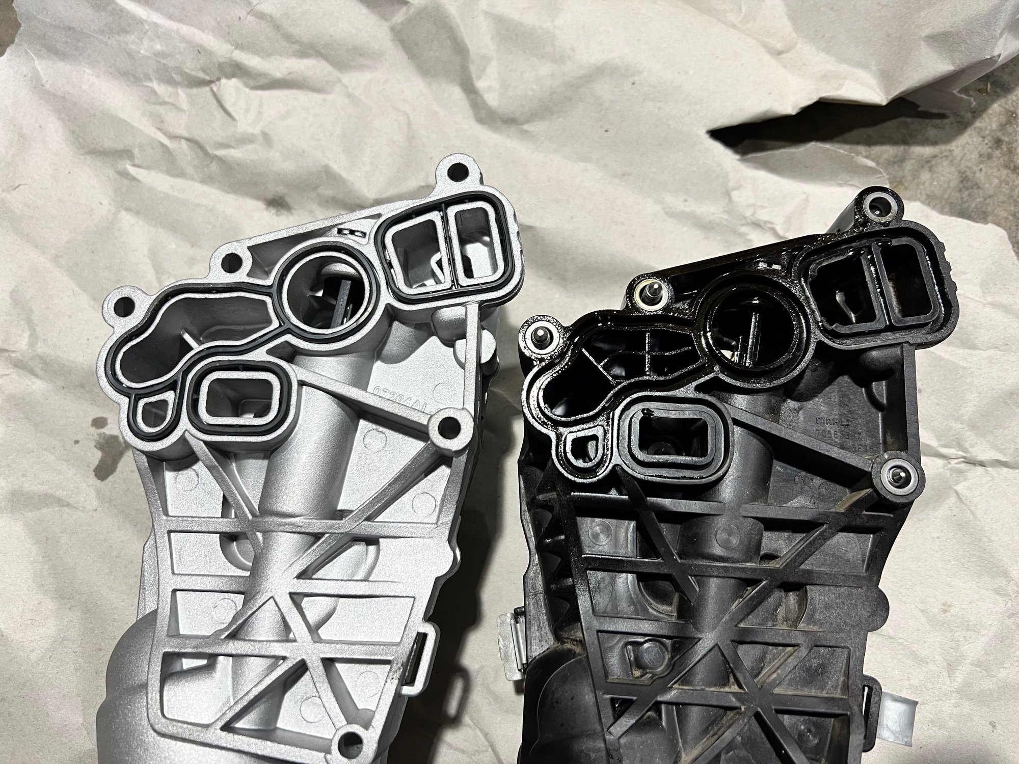

Yikes. I hope those gaskets hold. Were you lucky enough that the gasket at the failure location didn't split? On mine (failed at same location and in same manner as @AutoCoarsen 's pic documents) the housing break also split the gasket.
I'm simultaneously unsurprised (because this is how design fail works) and floored (because it is SO consistent) that every single failed housing I have seen save one -- and I have now seen at least 6 or 7 -- has failed at exactly this location.
The one I saw that failed in a different location was in a YouTube video, wish I could remember where to find it. But the failure manner was similar -- a slice-off on the inside edge of one of the channels at the assembly's mating surface.
I meant the 4 intake gaskets. The gaskets that came with the filter/cooler housing were already in the unit and well held in place with a plastic plate and rubber bands.
Here are intake gaskets that are a "confirmed fit" yet aren't even close.
Amazon Amazon
I actually had to drive about 5 hours today and didn't hear any boost leaks but I'm not sure how it would behave if there was boost leaking out at the intake.
And yes, the failure was exactly the same as theirs. The plastic gave way allowing the seal to just hang there.

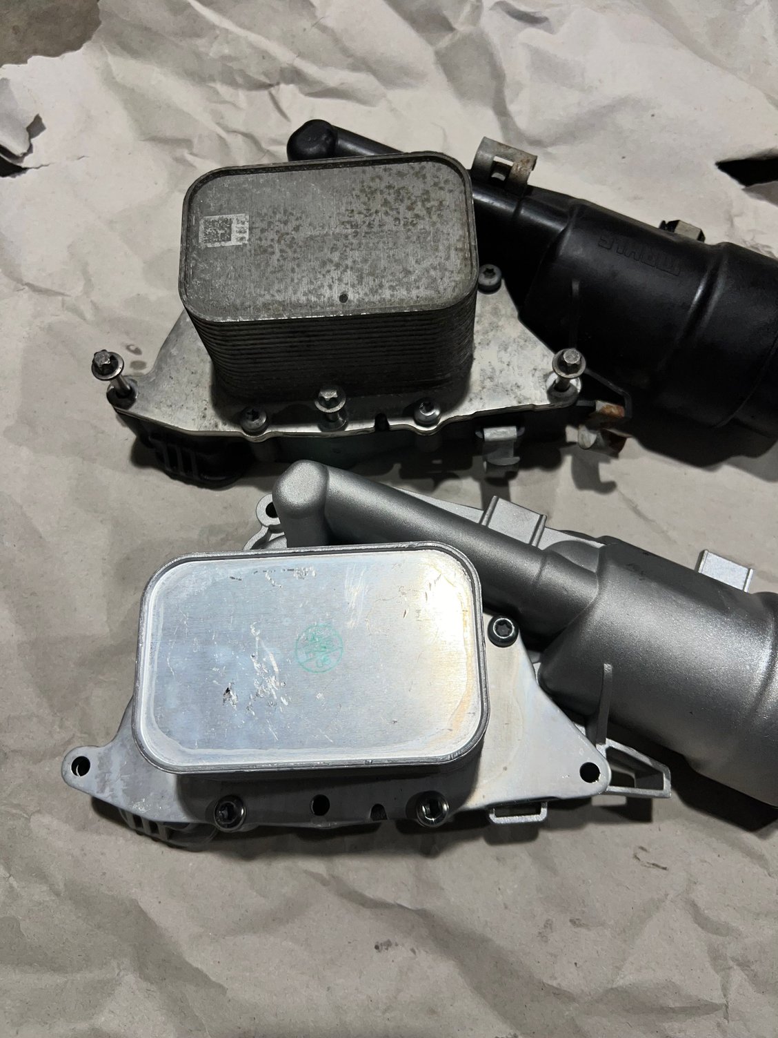

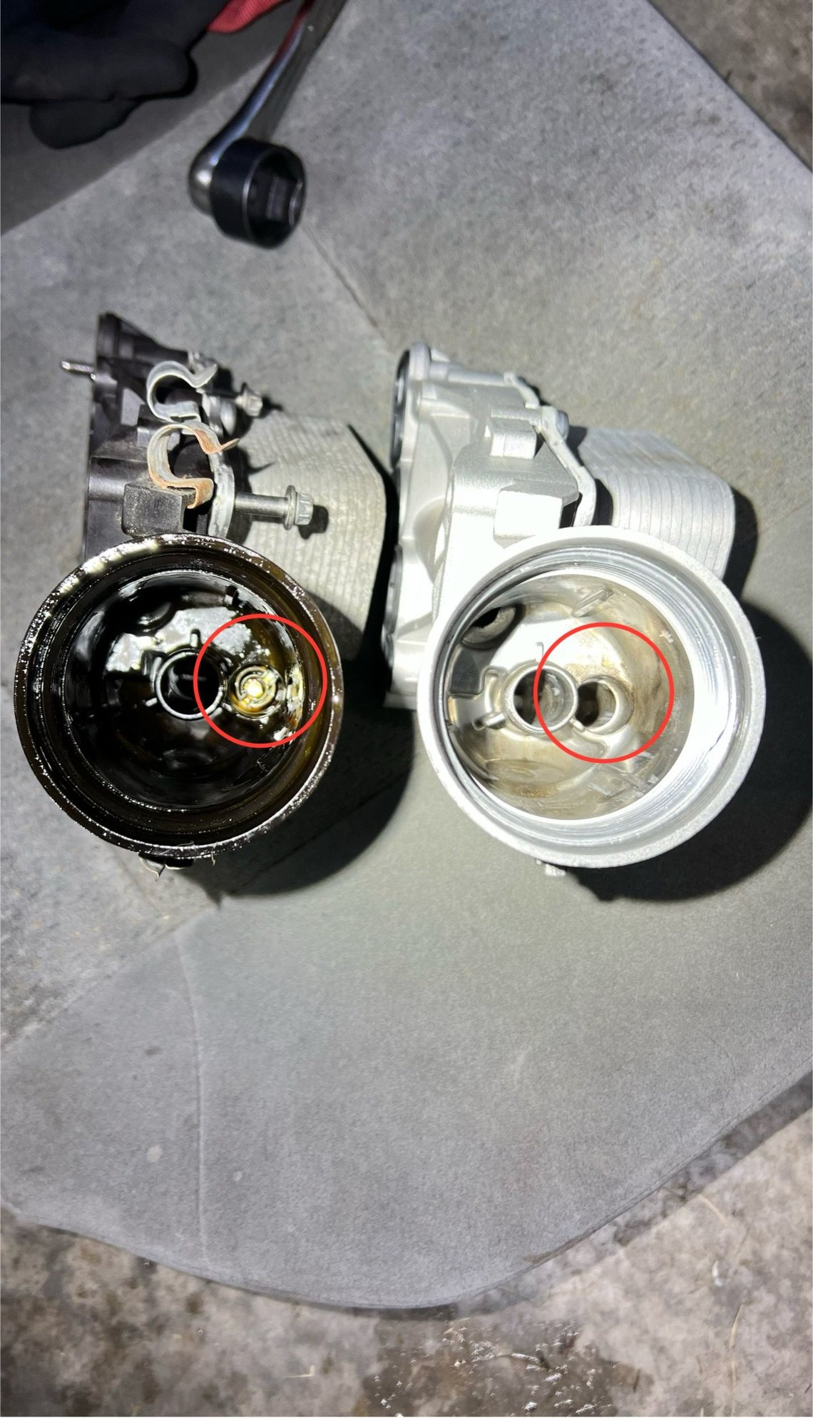

Grabbed a cheap, generic aluminum housing. From the photos on the ECS Tuning website, these do NOT appear to be the same item as the metal Bremmen one. Very close though. This is compared to my old, genuine BMW/MINI/Mahle one.
Honestly, it looks quite good 🤷🏼‍♂️. The oil filter cap drain plug is the only thing that looks significantly different. That comes new with a new filter anyway.
One big issue though… No check valve inside the filter housing! Watch for this if you buy one! Maybe it can be swapped over? I haven’t tried to take the old one out yet.
Did I miss how the missing check valve was addressed? Looking at installing this part when I reassemble the car this time around. Thanks in advance.

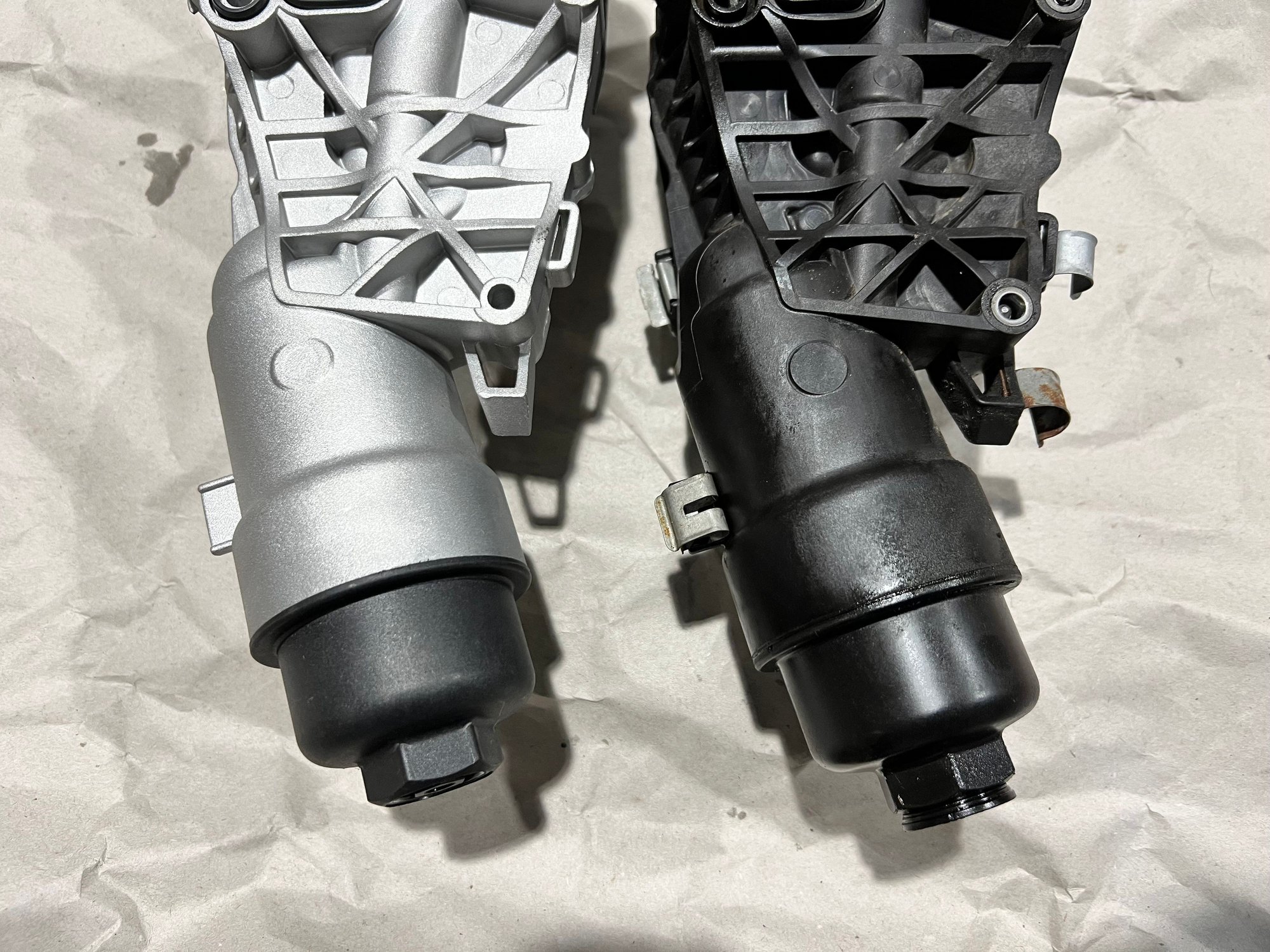

@barlowtj @ECSTuning
I just had my mechanic install the metal bremmen parts oil filter housing. He mentioned that all the screws provided with the part were the same size, when one of them should have been slightly shorter. He said he had to use a washer to be able to tighten that bolt.
Was that your experience with the bremman parts metal oil filter housing as well? I am a little concerned that he got confused and installed the shorter screw where the longer screws should go and the longer screw where the shorter screw should go.
