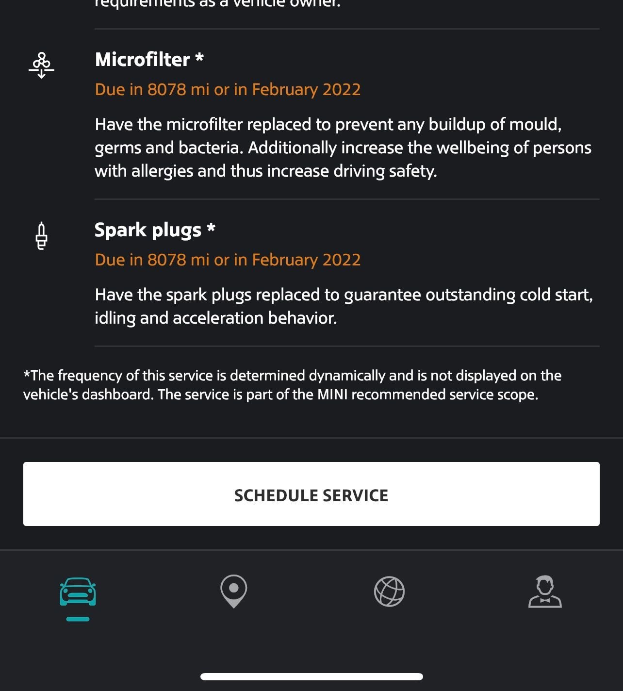

There wasn’t anything in the car that said the plugs needed to be changed. The Connected app, however, sent me a message about the service that was due, and in it was the note about the spark plugs needing to be changed. The oil, oil filter, cabin filter, and spark plugs were changed, and then the normal
swrvice reset was done. Presumably, that told the car the plugs were changed. Didn’t see any way to separately say the plugs had been maintained, so I’ve no idea if that worked!
