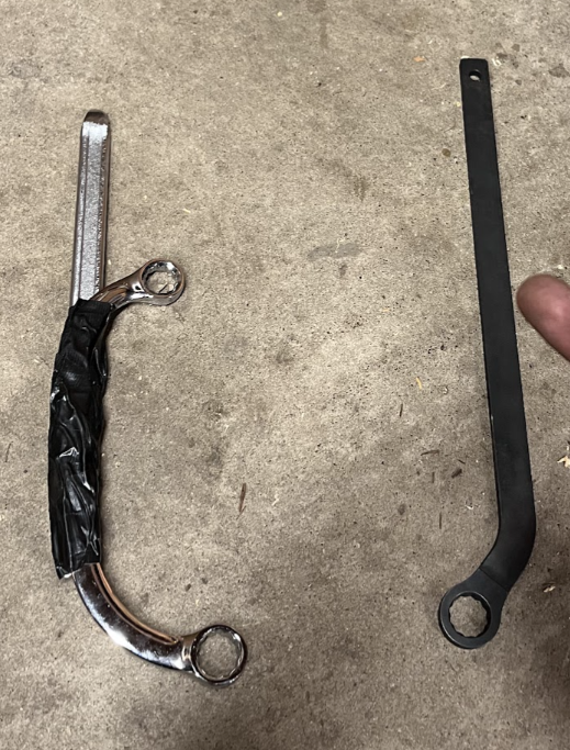

I purchased that tool and it does not work for the F56/F55 with the B48 engine, at least not mine. The socket size on the end of the tool is way to large for the tensioner bolt.
https://www.ecstuning.com/b-cta-tool...l/cta3884~cta/
Solid Bar with no rubber grip ^^, just make sure you wear some gloves so it will not slip off and hurt you hand.
Interesting, works on my B46 (2017), so the implication would be that the B46 and B48 have a different bolt/head size. I would not have expected that... though I have noted in at least some diagrams that the B46 and B48 have different belt-threading patterns. Different tensioner altogether maybe?

I wanted to add to this on the chance that someone comes along, I did this last night and what a PITA - was not a fun Saturday night at all. I bought the special tool for the job CTA3884 from ECS and it was no help, it kept hitting a metal portion of the engine that stuck out and wasn't enough to take the belt off or put a new one on. I'd wager if you took off the windshield cowl and sound insulation you might get an extra tooth that could prevent this but I don't recall ITSA mentioning this. I used a 19mm C wrench with a pry bar taped on to get further leverage - it was a bit sketchy but allowed me to turn the tensioner enough to put the belt on the crank. The Haynes video with the 3-cylinder is in no way representative of how tight the area is for the 2L.
In the end, I was able to snake the belt from the top down, using my C-wrench was able to get enough leverage to get the belt on the crank pulley and rotated the engine by hand to finish the job.
