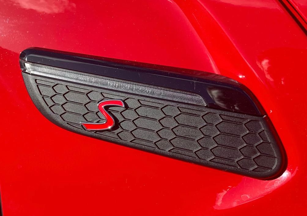

Hi Everyone, Question? So on my 2021 F56 JCW I updated my Side Scuttle Lights to the 2022 which I think are a great upgrade but unfortunately the blinker gives one blink perfect then goes super fast! Help with coding? I tried searching for the fix which I believe someone has done but I can’t find it. Help? Thanks, Jose

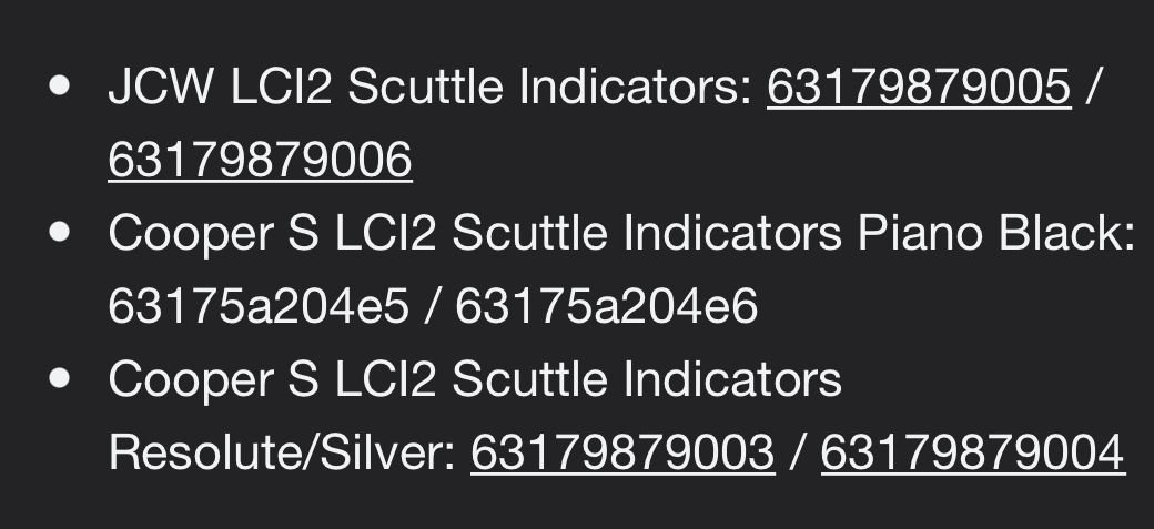

Ok, I found the information I was looking for. Here is the code to correct along with the part numbers…..
Part Numbers for Side Scuttles
“S” Version
“JCW” Version
Correction Codes
