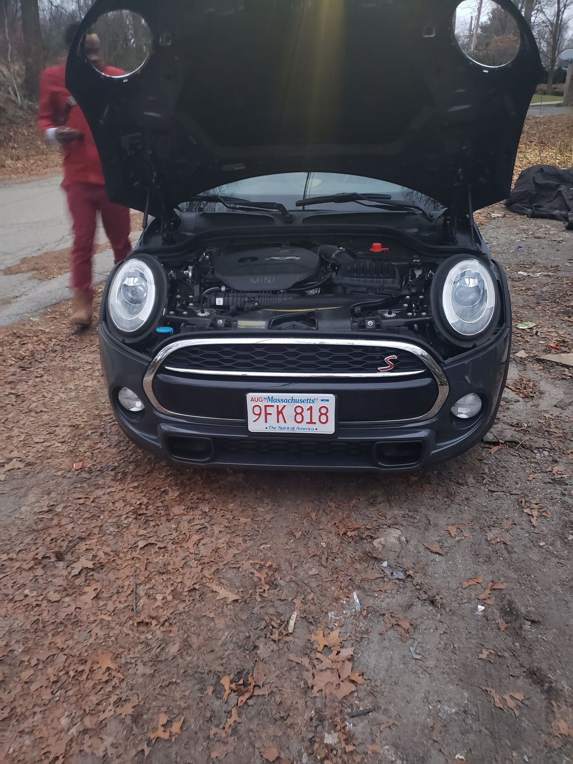

If you are looking to fix this bad investment up. You need to get us pictures of the current damage.
Go one step at a time. I bet you can find a replacement air filter from someone who has upgraded theirs.
Find a junker and get replacement parts for what's left on the list. Once you get to that point, please repost the codes. There are so many things wrong in the list you posted, there is no way to know whats going on. Solve problems you know, then come back with an updated list.

What ive found so far.
is that the throttle body (possibly tps, althought one unit) so it kinda sucks. or the actual pedal position sensor which seems unlikely. Is showing a constant 100% output regardless of actual pedal position.
the cars in limp wont rev past 3k rpm
But ive narrowed to that.
as well as. Maf sensor. Boost sensor (probably rebuild the turbo myself cuz of unsuriety. It's sounding like the diverter is stuck closed yet during my countless attempts already it's not boosting during 0-3krpm
i have inpa and all the coding stuff. But have yet to start snooping
because i find it weird that the whole intake sude of the motor just basically turned off
But i have 2 other things that make this so much harder..
Chassis stabilization malfunction*
and drivetedrivetrain error. Max output is not available.
So im thinking on how to reset adaptations completely or figure out how i can update and reprogram everything and pray that's the case

Until you fix the jerry rigged parts on the car you are going to be chasing your tail with codes and drivability problems.
1. replace all associated PCV lines (dealer noted they were glued together) you have a post maf leak causing multiple errors including lean situations
2. replace the intake hose that is taped together (same as above... post maf leak)
3. seal your intake box. not causing a code but you have unfiltered air entering your engine and can lead to damaged turbos and engine wear.
4. replace the fuel line with oem part
5. replace throttle body
Once you have your major mechanical problems addressed then you can begin to root cause your additional issues.

Have done everything besides the throttle body. New box. New line. Waiting on maf and boost pressure sensors to arrive
because im not just gonna throw parts at it when i seem to believe its being told/ commanded to do the wrong thing....
Meaning i can re-commanded it hoping to solve the throttle body / limp issue
Turbos are down the line. As in hopefully wont throw a fin but who knows. Only downside is if these diverter is indeed not functioning properly - possibly ecu coding there as well.
is possibly limp coming from theres as well

The b46/48 does not have a diverter valve. There is a electronic wastegate actuator mounted to the turbo which can cause boost issues

yes i actually own the mini in the photos....remember productive ...if i have to be nice then so do you or beat it

excuse me let me put a photo with the license plate so he knows....
