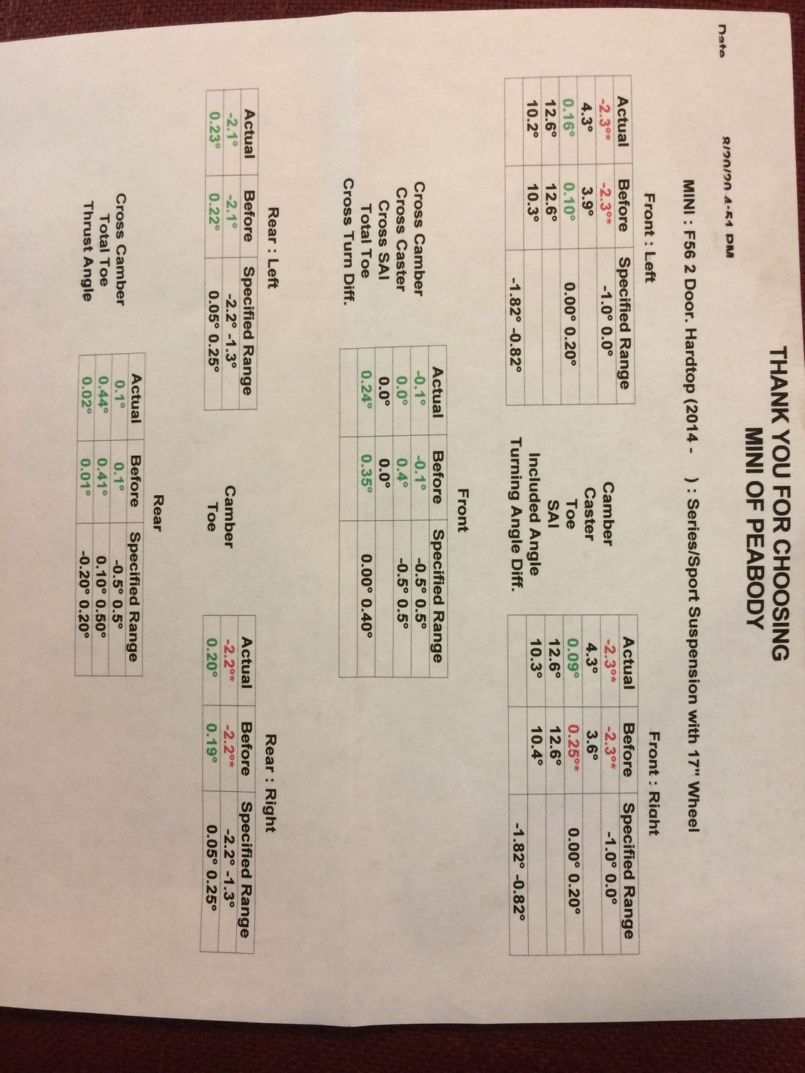

Darby, I'll post the alignment sheet later today. I am most curious to compare our two setups.
And yes I am jealous of the 235mm tires. ;-)

Height Fr 565mm 565mm
Height Rr 570mm 570mm
Measurement from Fr Tire (outside) to the Fr Tire (outside) is 68.25" ... 7.5mm spacer and 235/45/17s
Measurement from Rr Tire (outside) to the Rr Tire (outside) is 66" ... No Spacer and 225/45/17s
Last Alignment was Front Camber -1.6 vs -1,9
Front Toe Out was -0,05 vs -0,05
Front Caster was 3.6 vs 3.6
Rear Camber was -1.8 vs -1.7
Rear Toe out was -0,01 vs -0.02
Front Struts set at "7" and Rear Shocks at "9"
Running this weekend and upping tire psi to 37 front and rear to start (Yoko A052s) ... still working on psi and minor alignment and Strut/Shock adjustments
*I am running on RSe05s that are 17x7.5s

Thanks, that's pretty close to where I am now....
Jeremy nailed it! Yay Pit Crew...
