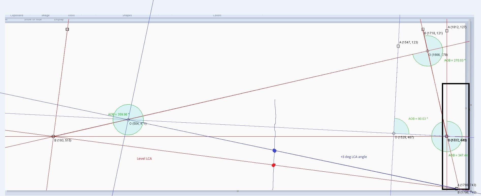

In this very sketchy sketch, where scale is approximate (wheels 25" tall, axle height 12.5", track 67"), it seems that dropping the outer ball joint only 15 mm (.6") will put a 10 degree angle on the LCA.
It seems that might well move the roll center upwards, closer to the roll axis, by 2-3 inches. Assuming the CG height is 21" that change would reduce the roll moment of the chassis significantly.
I sure wish I had the dynamic model, but I am just not willing to do the work, and spend the money and time.
At the end of the day, and as usual, the car will be better than the driver this coming season...
Cheers,
Charlie

OK Eddie, I realized I was getting lazy.
Here's the theoretical numbers for some variations in ride height and consequently roll center location.
From https://edfishjr.com/2017/11/29/auto...s-of-lowering/
Caveat emptor is an understatement, but I did find these results interesting.
Cheers,
Charlie

Charlie - Sorry for my confusion, but ... Above you say “if you lower the outer ball joint 15mm”. Is this to make the angle of the LCA be at the “stock height” angle? Assuming that the outer ball joint is the one next to the wheel, then this one doesn’t, in reality, move when raising or lowering the car. But if you are “moving” it just for simplicity in making the calculations, that would make sense.
An observation - Based on your calculations for 15mm drop, the 10mm drop MINI has used in the past for the JCW Sports Suspension is actually significant in terms of roll center and moment arms. Interesting!
Old Mar 6, 2020 | 02:00 PM
  #459
cmt52663's Avatar
cmt52663
Posts: 4,166
Likes: 402
Yep, what I meant was, the LCA gets 10 degrees at the stock ride height. Level for me at 15 mm drop. Mind you I assume 12" for the LCA, but that's not too far off I reckon.
And I too am impressed by the apparent sensitivity of the roll center. How much roll do I want? The lower I go, the more I get.
Way down the rabbit hole aren't we?
And I've not yet tackled the dynamic behavior - add 1.5" of compression and now what? How about the effect of lowering the CG on the pitch axis? It isn't just roll..
Oh my aching head.
Cheers,
Charlie
