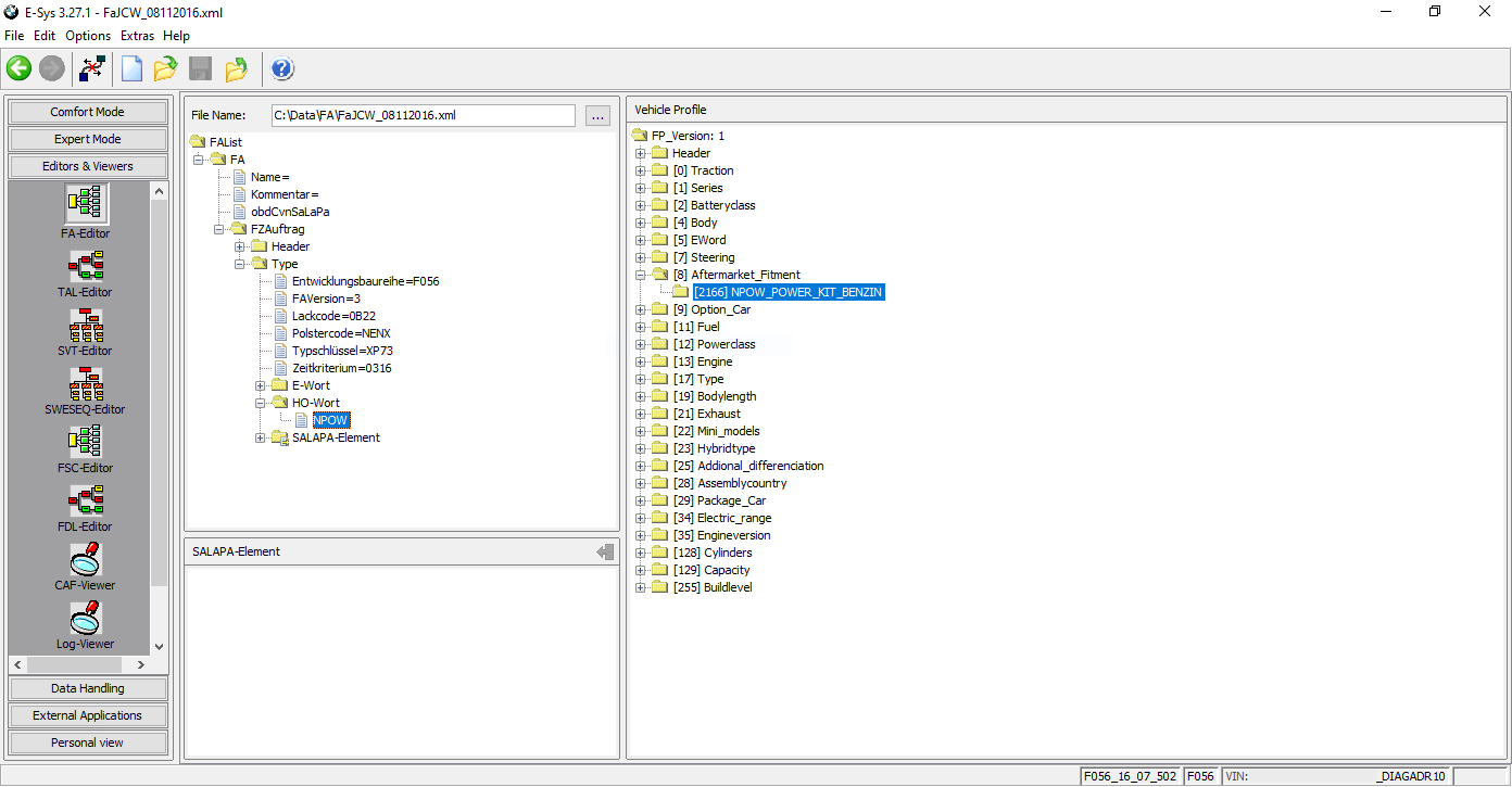

I have confirmed that the FA/VO now has an entry for "NPOW".

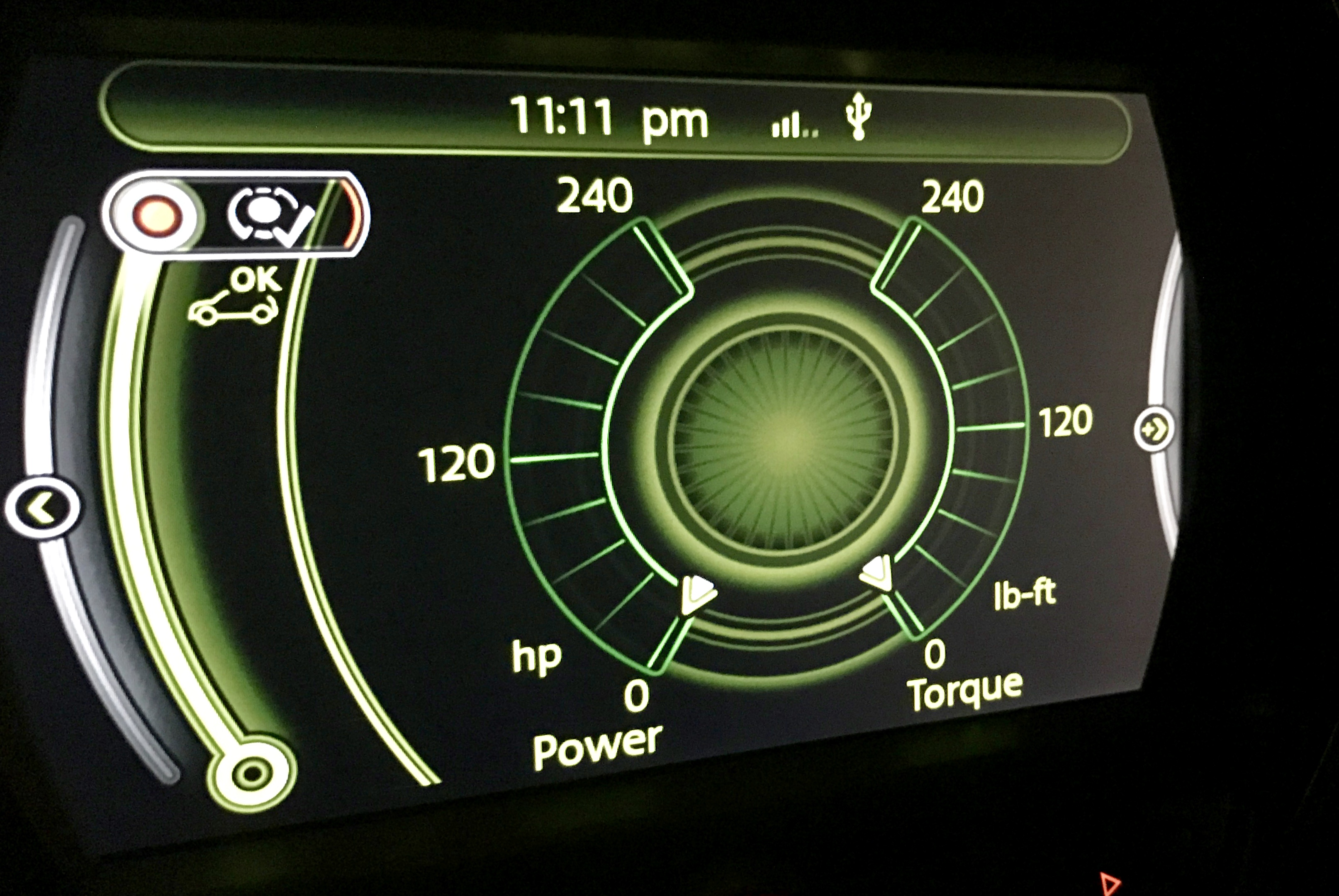

Hi guys,
Just picked the car up, now it shows 240 HP and 240 Tq and is a whole different car while driving so that along just prove that my dealer NEVER installed the tune!
Later today I will download E-Sys and check the files to make sure it shows the correct files, I no longer trust on the dealer.

The Driving Excitement gauges get their data from the DME (Engine) and EGS (Transmission) modules.
The JCW Tuning Kit includes a software tune for the DME module only.
Before the JCW Tune, you would expect to see 200hp and 240ft-lb on the gauges for a Cooper S (fJCW would already show 240hp/240ft-lb).
After the JCW Tune, you should see 240hp and 240ft-lb.
When you are driving, the small arrows will move up and down, but the 240h/240ft-lb figure always remain the same.
These values are likely hardcoded in the firmware of the DME and EGS modules. I've poked around in ESYS on trying to modify them, but there aren't any obvious options.

My MINI is a 2015 MCS w/JCW Tuning Kit. I just had a system software updated and when I got it back my 'Driving Excitement' gauge read 160hp/240lb-ft. (see attached) So I took it back to the dealer and they contacted MINI and were told there is a glitch with the Update and the tuning kit, and the driving excitement gauge. And the should have a fix by March. They assured me that the tuning kit is in place and the the issue is with the gauge only.
Since I would like to check it for myself.......I would like to download E-Sys software and check if the FA/VO says "NPOW" or not. I don't want to do any actual coding but just view the setting is correct. Can somebody give me 'step by step' instructions?
thanks, Hoopty

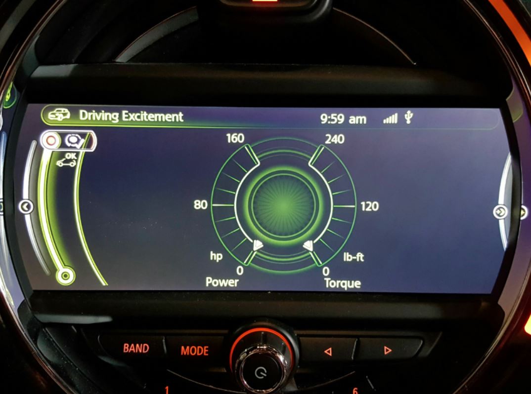

I just had my JCW tune kit done,,It does seem to have more power but my "excitement" readings dropped to 160/240 like yours did...my dealership was clueless...I asked for a E-sys printout , but they informed me they moved to the ISTA/P system and gave me a prit out from that system that they could not interpret...when I asked how did I know that the Tune was installed ...they answered " when you step on the gas you will know" ..BS

I believe you and I have been BSed about this ..we should be reading the 240/240 just like all the others on here who had it done properly..we have the same year as Vette and others...I am taking mine back and raising hell...!

Just ran out for a Shamrock Shake. I thought about this thread when I started the car and figured I'd make sure I still had the correct readings. I don't think I've checked it since last summer.
Yup, still there.
