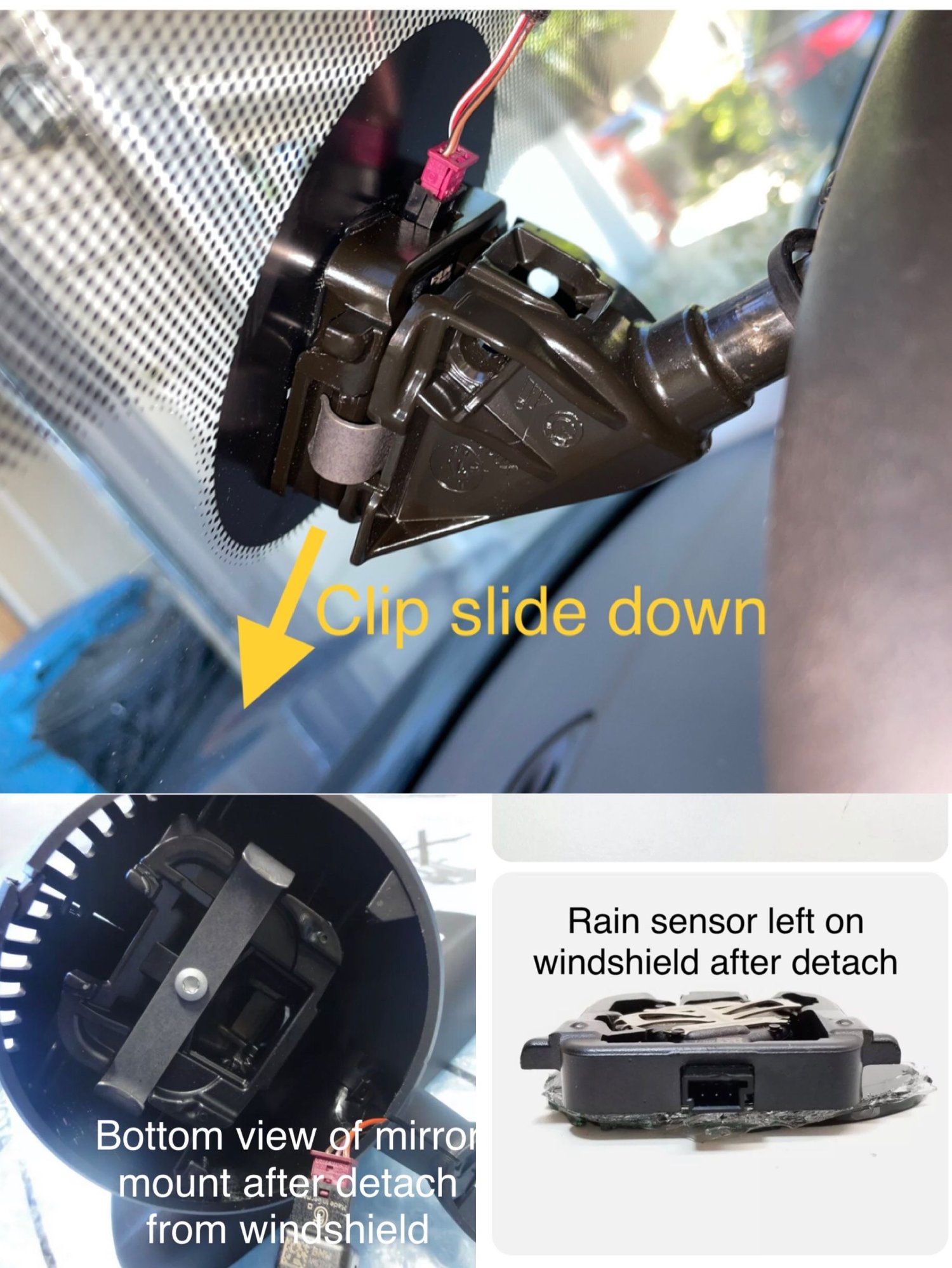

Thanks for Joseph ziptie solution. One caution is removing mirror: better yank down and away, not towards you, in parallel with windshield. This will remove entire mirror assemble include the ball joint so you have more room to work with. Here is a video how a professional removing it at 11:05 mark
. And install is reverse is at the very end of the video. The reason is the mirror mount is attached to a square rain sensor retainer beneath by a clip at its bottom; the clip is sliding in a groove in the rain sensor retainer. Here is illustration photo:

Also thanks for the video and descriptive pictures. Just to be sure, if you remove the whole mirror assembly, do the mirror clips just slid off (and then on) or is there a release on the Rain Sensor that you have to engage? If no release then interesting that the whole mirror stays on just by friction...?
Old May 23, 2022 | 01:01 PM
  #47
Min Zhang's Avatar
Min Zhang
Joined: Sep 2019
Posts: 4
Yeah the mirror assembly is hold mainly by friction though there are two bumps on the rain sensor surface that lock into the two ditches on the bottom of mirror stalk. That is why you need yank hard, not only to counter the snug fit clip in the rain sensor groove, but also disengage the bumps from the ditches on each side. Here is illustration photo:
