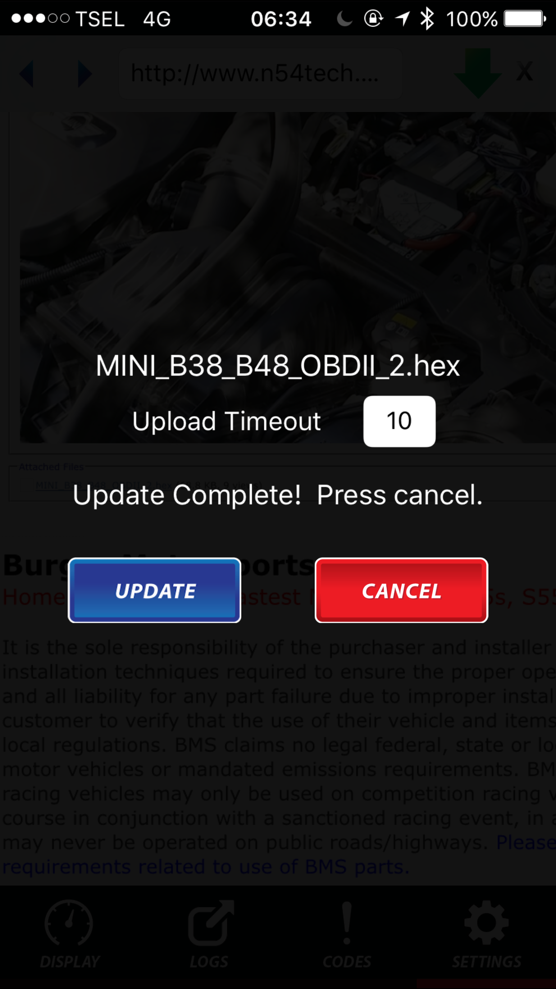

and in case noone noticed, a new firmware was released today. it's at the end of the first post.
http://www.n54tech.com/forums/showthread.php?t=33083

Will update mine today. Have you noticed anything new? I hope Oil Temp and Pressure is finally available on this firmware.
