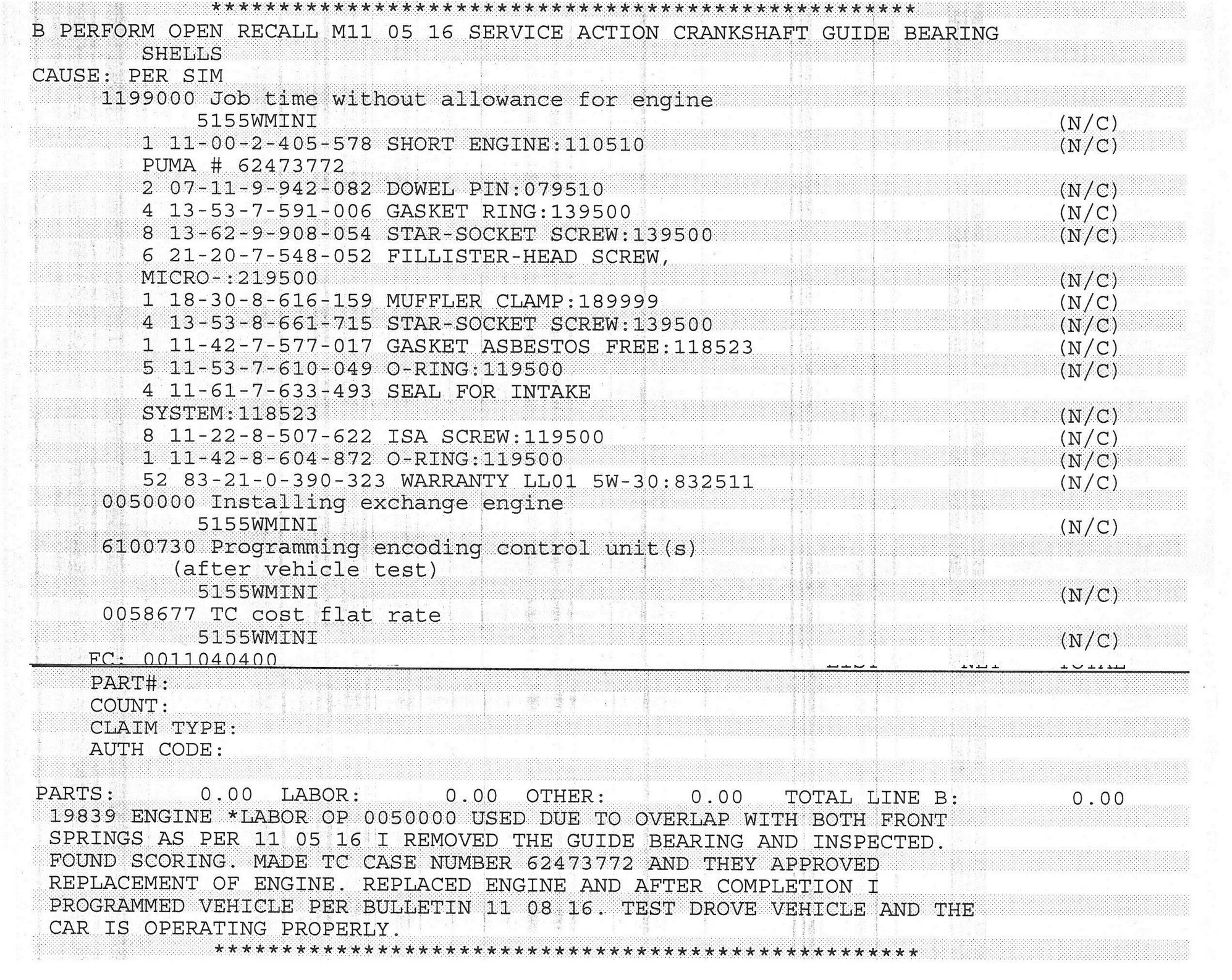

Posts: 168
From: Chicago, IL
Friends,
I just got my car back. A few of you asked for the work order report so I've attached it here.
Old Feb 26, 2016 | 02:22 PM

Wow the wear was that bad , it needed a new engine . How long did that take ?
Bearings were worn and the crank was discolored.
The dealer has a huge influx of people coming in for this recall. As of today, they've replaced 12 engines under the campaign and 8 before it was even issued. As a result of the demand, it took them 2 days just to get mine on the rack for inspection and about a week for the parts/engine to come in, plus install. Supposedly they had to push out the scheduling of the TSB since all the techs and loaners were getting tied up with engine replacements.
It's great to have my car back, especially after driving the gutless Justa Countyman (sorry Countryman drivers) while it was in the shop.

The WO states a "short engine", but I'm guessing that's not the same as a short block because they don't list nearly enough small bits and parts to scavenge from the old engine.
