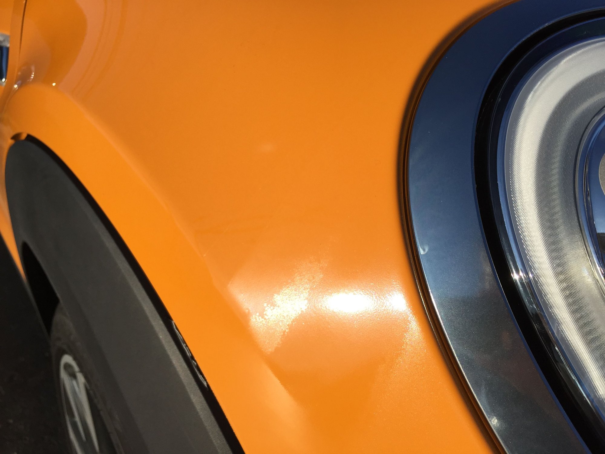

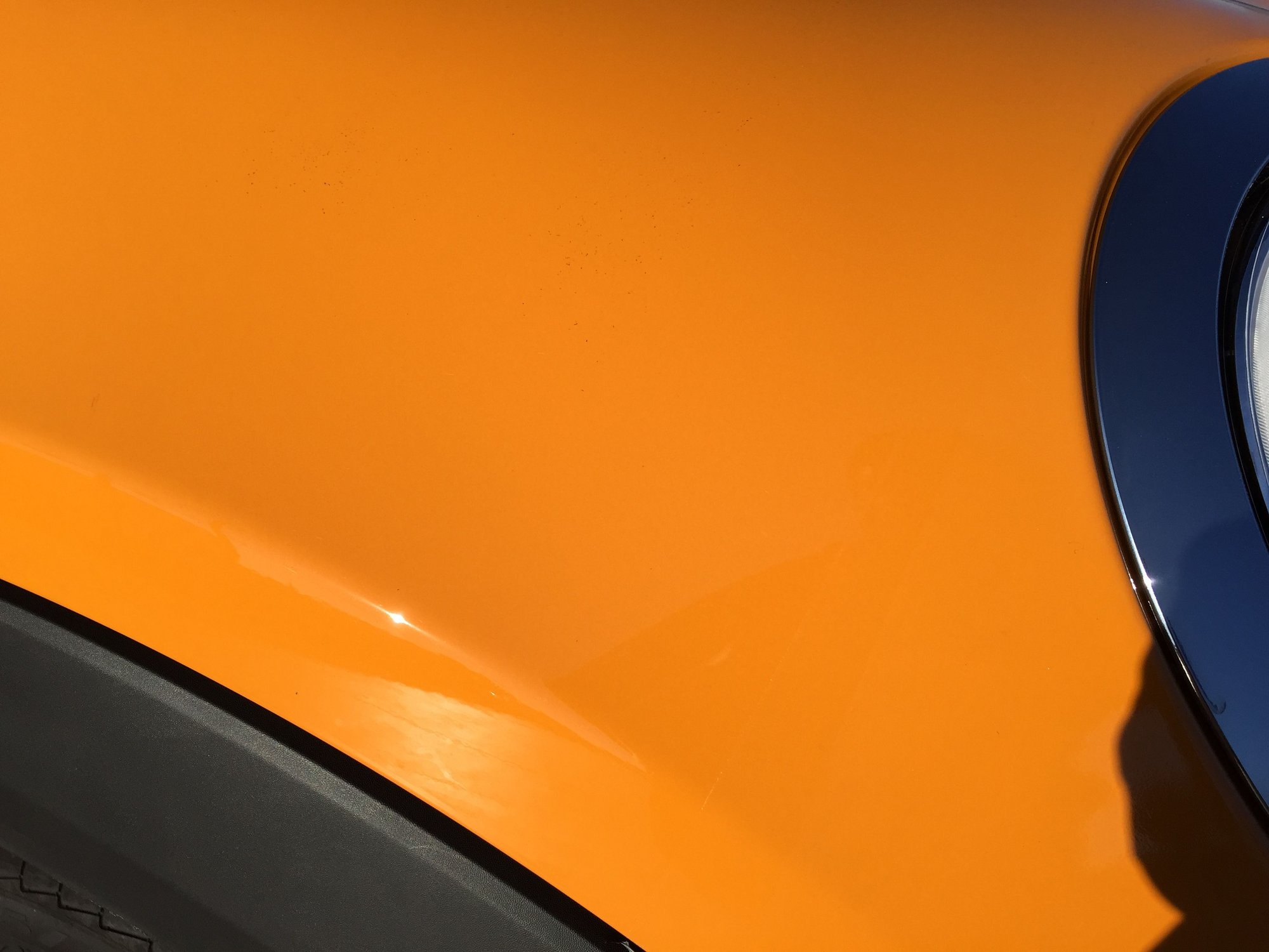

I am using the Plasti-dip Glossifier.
Started this afternoon, by the time I was done it was dark. Ill have to take pics in the day time.
In these pictures, I only had 1 layer done.

Looks like it came out better than I thought. Im still not 100% satisfied. I do see spray lines, that's because Ive never really done plasti-dip. So Ill probably respray it and I think itll look a lot better.

I did 3 layers. I dont think its enough. I should at least put 5-6 coats. Also there are some places that it had drip marks. Im going to take it all off and redo it.
