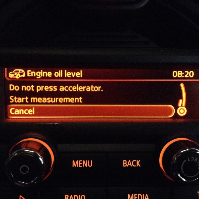

Hey there everyone, I have a quick question in regards to checking the oil.
If the screen says "Engine oil level OK" like the first pic I attached, does that mean it's 100% full?
When I try to start a measurement I keep getting the message in the second pic even though I've been driving the car for a good 30 minutes and I'm on fairly level ground. Wasn't sure how sensitive it is and if I need to be perfectly level. (I tried a couple different places with no luck)
I'd feel better if I could actually see what the level reading is. Any help would be greatly appreciated.
Thanks everyone for your help! Cheers!

Scroll down that message, there's another Start Measurement link. It will be greyed out if it is not ready for a measurement.
This is what it looks like when it's ready.

And like this when it's not ready.
