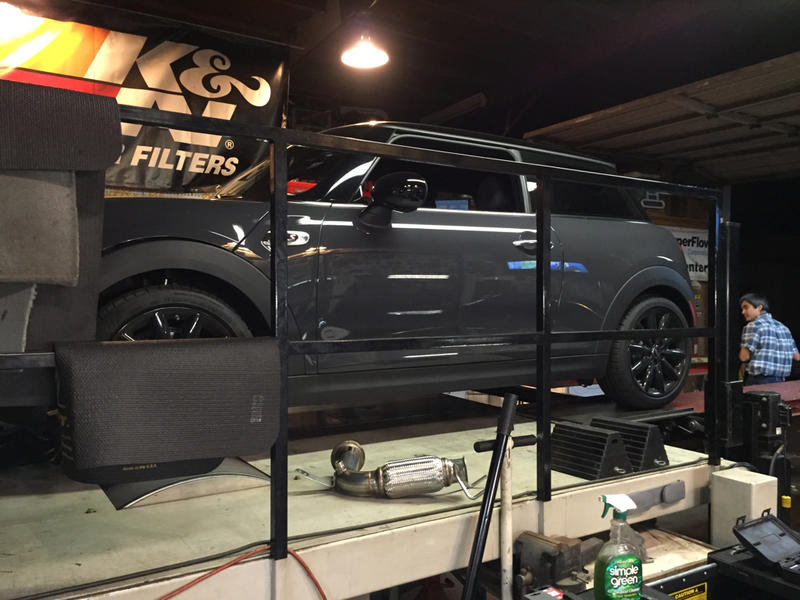

I tried dynoing a customers 2014 F56 maunal B48 and selected the hidden menu roller test and the car still freaked out on the dyno. Spent an hour on wasted dyno and $100. I thought the manual would be more forgiving. On the Roller Test it kept asking "ESC OFF"? I'm not sure how to confirm the ok. Need help Thanks Mario
Attached Thumbnails Cooper S F56 dyno mode: success-image-2598347586.jpg   Cooper S F56 dyno mode: success-image-2726817867.jpg

on mine to accept it you press down on the idrive ****

I tried that and nothing, also tried the BC button and anything that clicked

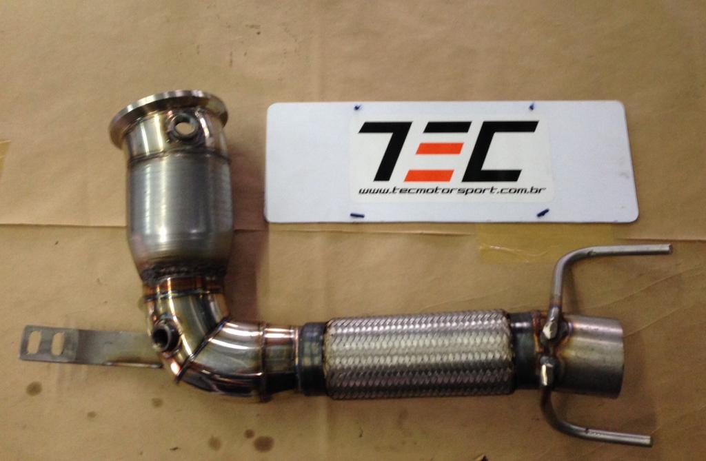

Using CAT from Summit
http://www.summitracing.com/int/parts/mpe-59979

I did it succesfully removing the traction control / ABS fuse, I can't remember the number right now but you will get it easyly under the globe box

I was able to do it through the menu, you just have to go through the menu before the car gets strapped to the Dyno

Yes you have to do the procedure BEFORE the wheels start turning on the dyno.

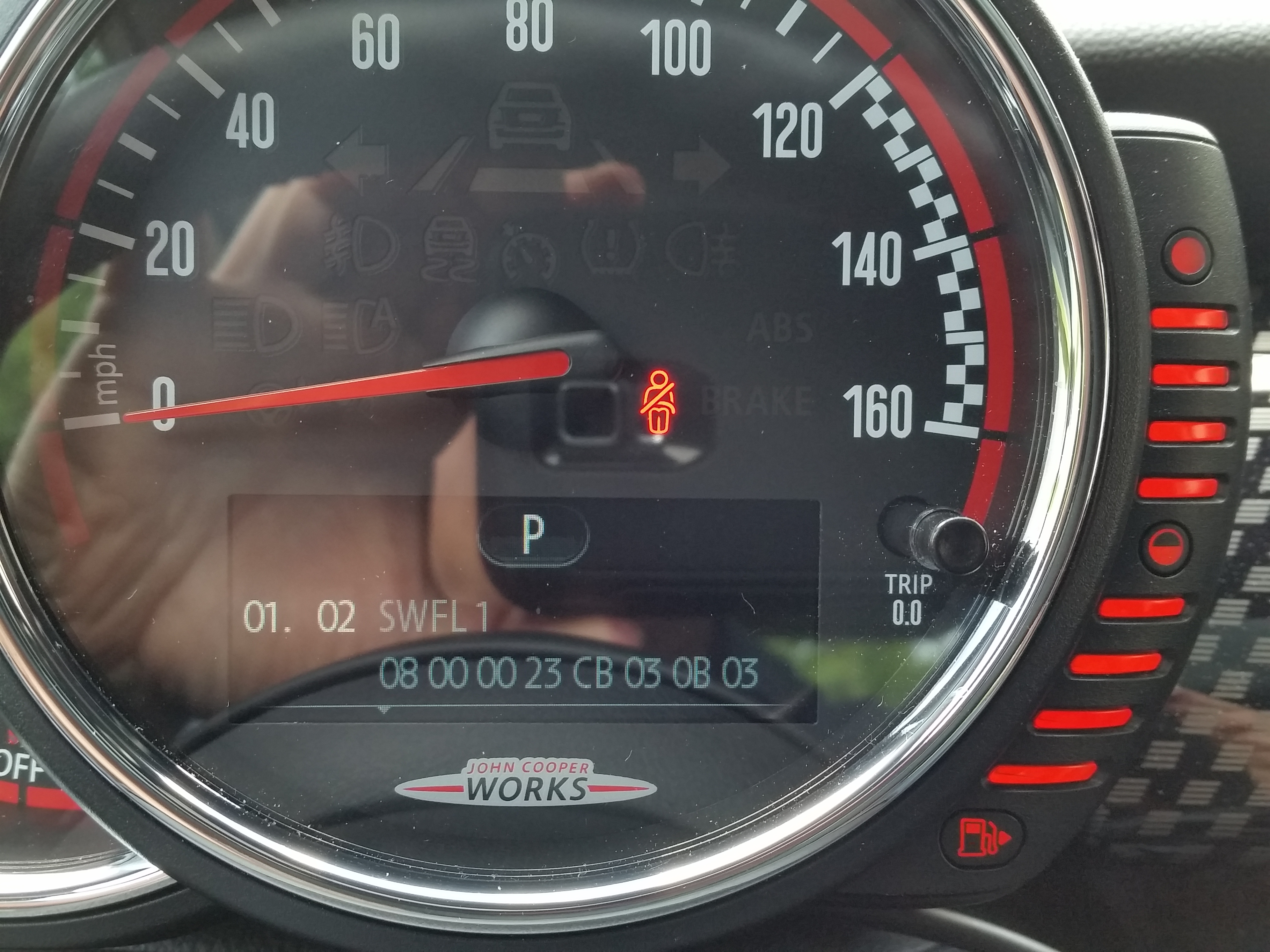

Can someone interpret the codes or direct me with a link? Also when there are choices such as 1) or 2) or more, how do I select one of them?
It took a couple of try's but I figured out how to get the 'hidden menu' display to show on my 2016 JCW.
Thanks, my 1st MiNi.
Originally Posted by Gardus
Tested on Supersprint dyno (just front rollers).
Here's how we did it.
Initially we had trouble (engine was cutting power).
The issue was that the car was tested once without activating the dyno mode.
We drove it a bit on the road to make the errors disappear then we did it like this:
1) Press the ignition lever once to turn the dash on
2) immediately keep the odometer reset button pressed for 15 seconds. The hidden menu will appear
3) press the button twice to go into "roller test"
4) keep the button pressed 3 seconds to activate it. You'll see a orange triangle then the start stop and DSC icons slashed
5) turn on the car and leave it on
6) put it on the dyno and set it up to be tested (OBDII plug etc)
7) activate the sport mode with the gearleve ring
8) launch
Car completely stock, tested on our in-house MAHA brake dyno, with water cooling for the IC.
206 hp and 309 nm:
