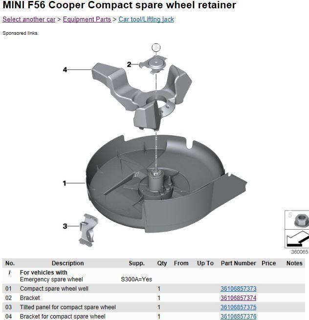

Bracket #3 on diagram
I had the spare wheel retro fitted and it turns out the chunky (angled as it called on the diagram) bracket screws onto the right rear lower suspension arm pivot, so the mechanic told me. It may be there to stop the space saver moving forward into the suspension arms, I can only guess.
Are there parts needed other than the ones shown in the pictures on the previous page?
Perhaps someone who has a spare from the factory can snap a pic of where this bracket gets installed?

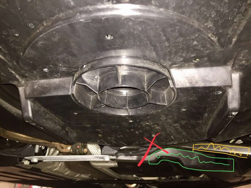

F56 compact spare retainer
I’ve drawn on the pic by the original contributor (very high tech) showing the area in question. I had a glimpse after the bracket went on......goes like this I think; yellow area is suspension arm, green area is a plastic housing which needs to be dropped to allow access, and red cross is roughly where the bolt goes through (behind spare wheel).
It it would appear that the parts required are all in the diagram. Longer suspension joint bolt not required. I’ll get the spare wheel off and see if I can get a pic.
PS I should have also said that the position and orientation of the bracket in the exploded diagram (just forward of the spare) is about right, although in practice, once fitted, the wheel housing and bracket are nearly touching......if you see what I mean.
The whole procedure only took the garage 10-15 minutes. Hope this is helpful.
Thanks! The red 'x' marks where part #3 in the diagram is installed? I'm very intrigued by this add-on, as my MA told me that the spare couldn't be fitted after the fact. I wanted it, but for the 2019 LCI cars the only way to get it is with the base 15" wheels.
