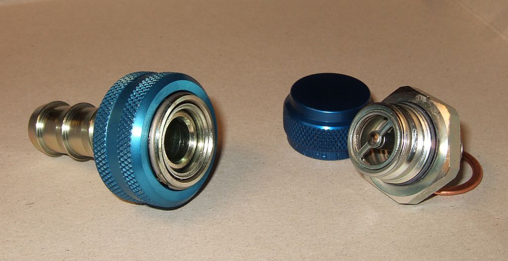

That Stahlbus quick connect looks pretty nice, may consider it at a later date. I ran an Aeroquip one on my former Subie (see below) and loved it, especially since Subaru decided to use an M20 drain plug...talk about fire hose drain rates! The Aeroquip made drains so much easier and cleaner. The new owner of my Subie called to thank me for installing it when he changed the oil, so at least someone else will get to enjoy it as well.
