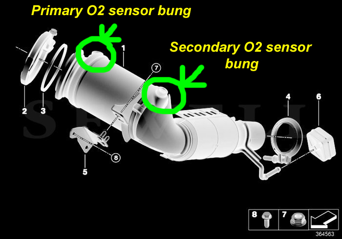

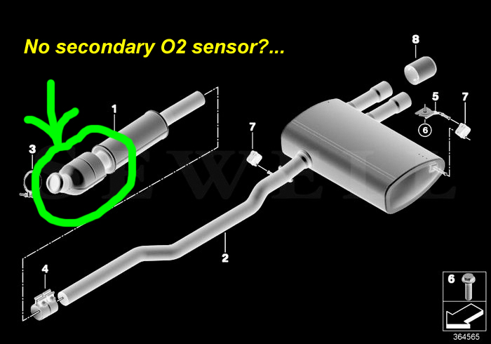

Not to derail this thread too much but I just discovered something very interesting: It appears that there is no O2 sensor downstream of the secondary catalytic converter of the F56. The primary and secondary sensors are both located in the first catalytic converter. In other words, there is no OBDII data reporting beyond the primary cat. What this means is that you should be able to entirely remove the secondary cat without the ECU realizing that. An emissions sniffer would probably pick up on it but the ECU won't. A test pipe could be real easy to fit into one of these cars.
Attached Thumbnails F56 JCW Bi-Modal Exhaust-35571.jpg   F56 JCW Bi-Modal Exhaust-35573.jpg

Nice find. Your curiosity killed this cat!
Second cat decat will probably be a common tune of this car

Awesome!
Thanks. I may just add the high flow cat to this car too.
