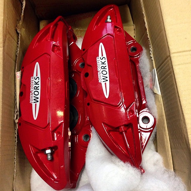

On Monday I decided to order up the F56 JCW brake upgrade. This compromises of the following:
For the front:
2 x 4 piston Brembo calipers in red with JCW logo
2 x 335x30mm drilled and grooved discs
2 x sets of pads
2 x sensors
2 x backing plates
All mounting hardware
For the rear:
2 x rear calipers & carriers painted red (same as Cooper S, just red)
2 x rear plain discs (same as Cooper S)
2 x sets of pads
2 x sensors
and the callipers look like this! :cloud9:

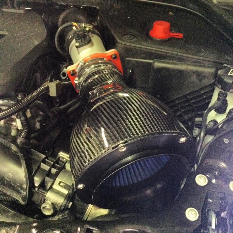

Today I took a trip down to Evolve Automotive in Luton for the fitting and testing of the GruppeM carbon fibre intake. This is their 'Super Cleaner' pod design which houses a K&N filter.

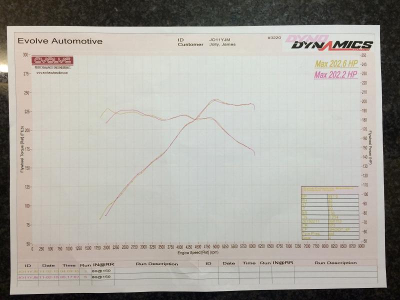

I got the car down to them for just before 11am and they set about doing some pulls on the dyno with the stock airbox where the car hit a peak of 202.6 bhp, not bad considering the only performance mod is the Remus valvetronic exhaust!!
Pleasantly surprised, they then swapped in the GruppeM air intake and over the same number of runs on the dyno the car hit a peak of 202.2 bhp with a 1 degree increase in IAT, again impressive considering the lack of direct cold air feed like the OEM system.
The biggest benefit for me about the GruppeM is this..... don't think it will get boring for a while!! :excited:
Dyno sheet for those who are interested:

Originally Posted by R99
...with the stock airbox where the car hit a peak of 202.6 bhp...
So the GruppeM air intake and the stock airbox dyno results are the same within 1/2bhp? I think I'm not understanding something here ...
What is there to not understand?
The OEM box made 202.6 bhp and the GruppeM made 202.2 bhp
The GruppeM is sold without any dyno evidence (like every other F56 intake on the market, except the ARMA) so there was always going to be an element of risk associated with buying it!
The main benefits of the GruppeM (and probably the others on the market) is the ridiculous increase in the amount of induction noise, which can be heard in the video I posted. Alongside much better looks (not true of all the kits on the market) when compared to the stock system which is a big black plastic mess!
Nobody is sticking their necks on the block and testing things for the F56, so I wanted to do some real world tests with back to back dyno runs and to be honest I'm not disappointed at all - same power as before and much better looks and sound!!
