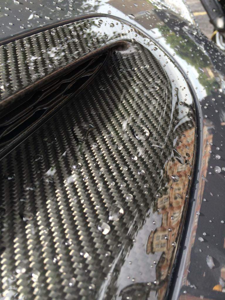

Just thought I would share a couple if beading pics to show how the Gtechniq coatings deal with the rain - very impressive

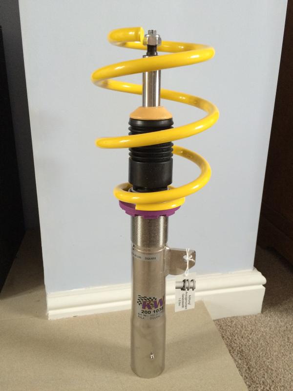

Fairly big update... the KW Coilovers arrived today!!
V1 (Inox)

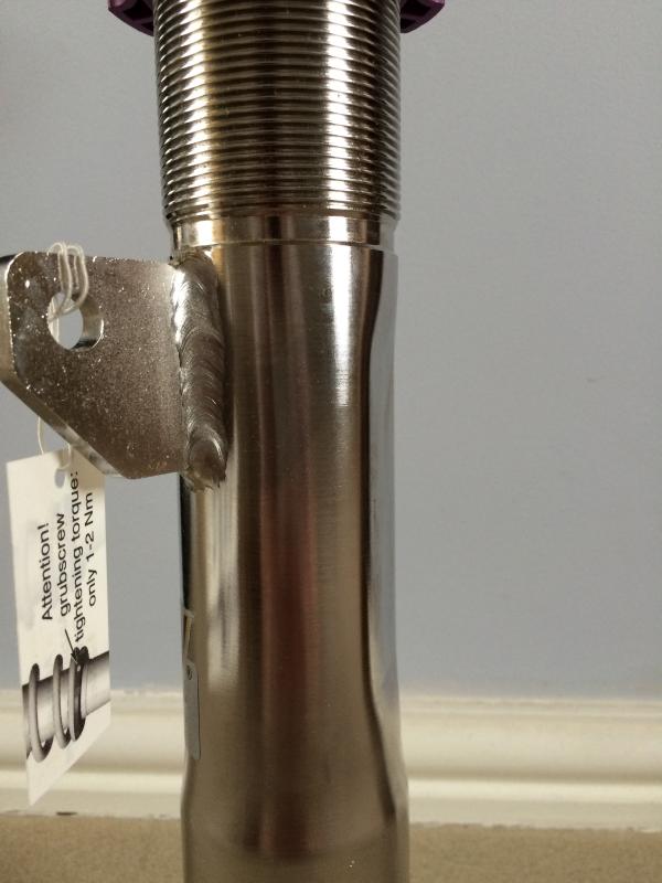

Unboxed a front strut and they seem to have replicated the indent from the OEM suspension which should hopefully mean I can get my 18x8 ET45 wheels on without a spacer (they currently fit fine on the OEM set up)
Indent on the KW's:

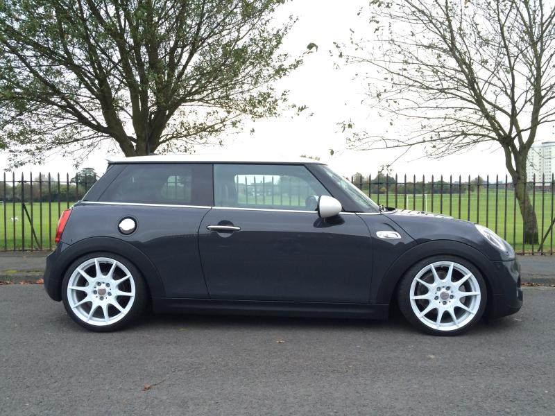

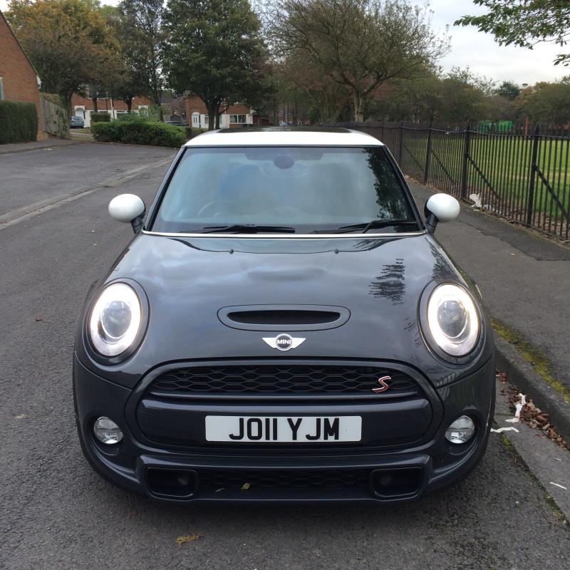

Update - they are on, and they are as low as they will go!
The good news for F56 owners is that I can confirm that 18x8 ET45 with 205/40/18 tyres DOES NOT need a spacer. The bad news is that this set up is as aggressive as you can really go without encourtering unesscary headaches with fitment.
The fronts rub slightly on full lock when negotiating heavily cambered roads / drives at medium to low speeds, but its fine everywhere else. This will be solved with camber plates as and when they are available to order. Camber plates will be essential as currently I can only get -0.4 degrees camber with the stock set up. The rears don't seem to rub at all and I've had -2.4 degrees of camber dialled in, which obviously helps.

No rubbing before coils
Small amount of rubbing up front with the ride height as low as it is. Only on full lock / full compression which is a rare occasion anyway.
