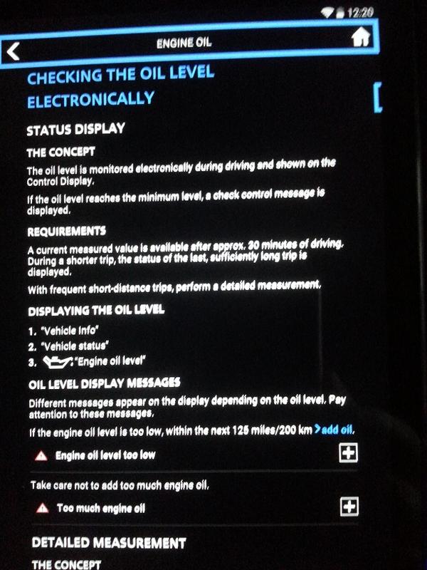

Related, I looked at the electronic dip stick indicator on Saturday at the dealer's open house. Wondered how it indicates the amount of oil one would need to add when it gets low. My MA did not know and the only option, draining some out was not available, so does the manual indicate how this works?

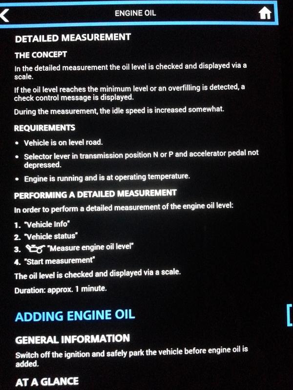

Here are pics from the Android App owners manual.
The part needing clarity "The oil level is checked and displayed via a scale". Yes, what I saw on the 4 line display was a line, I hesitate to call it a scale since it had no markings to indicate scale. What does the total "scale" represent? Will we get a result like "down a certain number of oz." or what.
Maybe others that have experience with this would like to comment. I don't have an issue about the lack of a physical stick, but given the critical nature of the oil level, I would just like to know how to determine what to add. Maybe we just wait or maybe it has a better indicator with the larger screen.
