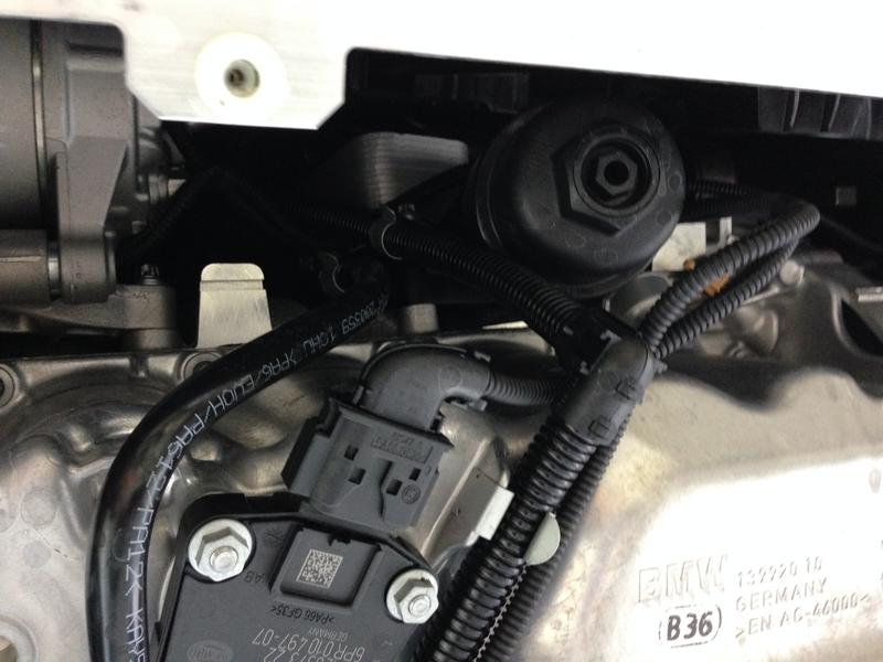

Oil Change Information
Originally Posted by QBear
Yup, it's 11 42 8 570 590, and it includes a new O-ring for the filter housing and a new flat gasket for the drain plug.
Be careful and get the part number above. I asked for a filter for my 2014 F56S and the parts guy handed me a 11 42 7 622 446 which at this point I'm guessing goes into all the R cars but is about half the length of the one I needed. So now I have changed my oil but NOT my filter and I'm hopping mad at Mini of Birmingham.
Anyway, the oil change was pretty simple. There are 14, 8mm hex screws that hold the under belly cover on, which hides everything. With those screws removed, simply slide the fiber belly cover off to the rear. The oil drain is on the passenger side and is a 16mm hex. The oil filter housing is the traditional BMW black plastic unit and is to the front of the car on the engine about mid-length, and has a 32mm hex to remove it. There is a smaller hex inside that 32mm one on the housing but it didn't look substantial enough to me to want to use it. I got my oil sample and will be sending that off for analysis in the 6/1 mail. I'll publish the results when I get it back. I've included a couple pictures. The first is the underside of the engine once the belly cover has been removed. The second is of the oil filter housing with the double hex for threading it on and off.
Motor On!
Motor On!
I got my oil analysis back from Blackwood (attached) and as anticipated the metal content is high. But if you read the comments, that's somewhat to be expected in a new engine. This is a good reason why I don't like going 5K or 10K miles before getting all that crap out of there. I'll run this analysis again at 5K and then at 10K and maybe then at 50K boundaries.
Also from my write up above I made a mistake. Turns out the smaller hex is for draining the filter housing before removing the housing to change the filter. Seems the filter comes with an O-ring for the housing, a crush washer for the oil pan drain plug and a replacement of this housing drain. I still hope somebody comes up the a spin on style filter adapter for this engine. I got one for my 911 and it's the best money I ever spent for relieving the mess that can be made with this cartridge style filter/housing.

Regarding the oil filter housing: The smaller hex fastener is to drain the oil out of the cartridge so you don't make a mess when you remove the housing itself. Lots of manufacturers (including Toyota) have gone this route... once you get used to changing the oil this way it really is better. Even though it's an extra step, you don't get hot oil on your hands/floor.

Don't shoot the messenger for the message. I didn't design it, but I sure did have to remove 14 sheet metal type screws to remove the fiber belly cover and access the oil pan and filter.
Pretty easy! Mine is an F56-S. I found that the 14 sheet metal screws and fiber cover can be left in place. There are two flip-down hatches, about 4" X 4", built into the fiber cover. Open these hatches to access the oil drain plug and the oil filter. Each hatch is held shut with two half-turn screws that are easily opened with a coin.
It took 5.0 quarts of oil. I initially added 4.5 quarts, started the engine, then checked the electronic oil level. The oil display level was halfway between to low and high points. I then added a half quart, repeated the electronic oil level procedure, and it indicated full level. DONE.
My mistake was not having a 32mm socket to remove the oil filter housing. Now that I have the proper socket, it should be much easier next time.
I've had the car for 10 days, and just changed the oil at 1000 miles. I plan on doing it again at 5000, then every 5000 miles thereafter. The dealer said they do it every 8000-10,000 miles.
