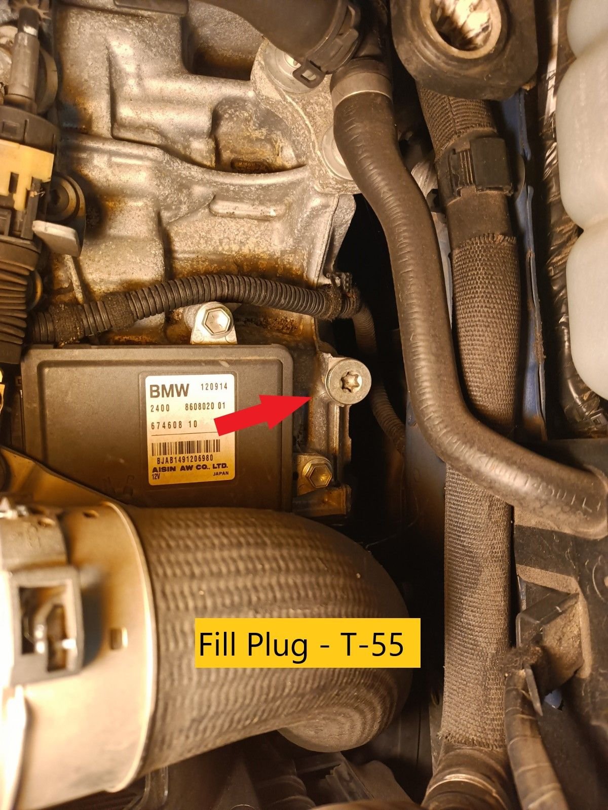

Hi all - just did the automatic drain and refill procedure on my 2015 Mini S 2-door. Search as I might, I could not find a video or picture guide for the F56 - lots of 2nd gen and Countrymen etc., guides but not for the 3rd gen hatchback. So, I took a few pictures to ADD to this thread - thank you to @Chazman for his basic set of instructions that I followed and I'd like to add on to these steps with what I observed and took pictures of (mostly the initial steps on my F56S):
  1. I put a level on top of the sunroof and then jacked up all four wheels and ensured the car was level. Be safe - use jack stands/blocks/etc. I am doing the COLD drain and fill with same amount of ATF.
  2. For the F56S, first remove the Air Intake and the MAF/Air Filter box. This is shown in the first picture. I believe the air intake runner uses 10mm bolts (2 of them) and then it clips onto the front of the air filter box.
  3. Second picture shows the MAF/Air Filter box. It is attached with one 10mm bolt. Loosen the screw clamp with an 8mm(?) socket. To remove the electrical connector from the MAF there is a white clip on the bottom that you must slide back to release (I had to us a small screw driver). Also wiggle off the wiring harness from the metal tab.
  4. And voila - to the right (driver's fender firewall) you will see the Fill plug. As wisely stated by TVPostSound - loosen this plug first! See picture 3. Now time to crawl under the car.
  5. You need to remove the large splash shield to gain access to the transmission drain plug. There are 14 screw bolts that need to be removed with I think an 8mm socket (I may be getting the 8mm and 10mm bolts mixed up..). The fourth and fifth pictures show the front and back of the splash shield/screw bolts. Only retighten these to a gentle snug as they are easy to strip through the plastic clips.
  6. My sixth and final picture shows the incredibly creative ATF catch container I fashioned out of a gallon milk jug and a small funnel. I measured and marked the quart levels (dashes) and the top dot is at 3.5 quarts. As mentioned by others you will get about 3 quarts out with this cold drain method. Above the jug you will see the T-40 overflow screw which you will take out first. Then the main drain plug which takes a 17mm hex bit to remove.
  7. The fun begins! I carefully position the jug. Insert the T-40 torx bit into the o/f screw and loosen it. I then carefully unscrew it out with my fingers, and, it falls into the funnel. OK - I'll get it later after the initial small amount of ATF comes out. Wrong! The screw went straight down into the funnel drain and plugged it up AND about 1 quart of ATF will come out here!!! I'm trying to reach the o/f screw but can't without tipping the funnel over and spilling all of that ATF all over my hand and the jug and garage floor. Nice!
  8. After that mess wipe up, it's time to remove the main drain bolt. But, in my prep haste I read in my mind it took a 17mm wrench to remove, bit it is a 17mm hex bit and I don't have one!! I try to jury-rig up an 11/16" bolt which is close to 17mm but it is too small and starts to strip inside the drain bolt. So, after a cleanup and a quick bit to eat for lunch, I called around and found an O'Reilly auto parts store that had it in stock....I begged but they wouldn't deliver. I now start roaming my neighborhood to see if any neighbors have this 17mm Hex bit or will give me a ride to the auto parts store. One of my neighbors is home, but he doesn't have one, but he said let's check one house down as he is an ex VW mechanic. Couldn't believe it but he had a 17mm Hex bit!!!
  9. So, next is removing the main drain plug. I carefully removed it by hand and it poured right into the funnel. Good, right? But no...the volume of exiting ATF was too much for the funnel to handle, and, it overflowed all over the floor! :-( So, I wound up with 2 quarts in the jug and I approximate about 1.1 quarts on the garage floor.
  10. Once clean up was finally done, the fill process went without much excitement (yay!) I used Liqui Moly Top Tech 1800 which meets BMW specs for this transmission. I put in 3 liters which equals 3.18 quarts based on the amounts from others who have done this since I couldn't be accurate with my special jug where a good quart wound up on the floor. Another story to tell...
  11. I have to say my car seems to feel a bit smoother shifting now, especially the 1st-2nd shifts, so I'm happy with the effort. If you don't mess up plan on 2.5 to 3 hours all totaled in getting everything ready and then cleaning all your tools and putting them away etc. Of course my adventure took 6 hours! Have fun and thanks again to this forum for all of the info and guides and support here.

Originally Posted by TVPostSound
Engine running?
Trans fluid temp?
Why did you use AISIN ATF0T4??
2017 Calls for ATF 6
Followed the service instructions from BMW. Multiple checks with engine running including initial idle, final step with engine running at trans fluid between 35 and 45 degrees C. I was at 41/42 degrees C (by AT fluid temp sensors 1/2) for final check.
I don't know (because I've read this thread too many times) whether there has been discussion of moving through each gear step at least 2x with at least 2 seconds in each position with foot brake applied and while engine running -- to get the fluid moving into/through the torque converter, presumably -- but I did that too. I actually did that for each level check cycle, from initial to final, with final step being top-off and resealing the overflow plug.
Also made a point of replacing the O-rings on each plug. It's a smart move, BMW calls for it, and the condition I found the originals made it clear that I had made a wise proactive choice. The O-ring on the overflow plug in particular was actually chewed up pretty good.
Re the ATF choice, the short version (***EDITED 26 Nov 2023***) is that I flipped the last 2 characters of the AISIN part number for the transmission and got myself into a mess of confusion where I thought I was reading the spec for the F56 transmission (part ends in "AW") but I was reading the spec for what is apparently its predecessor (part ends in "WA"). It has not killed my transmission as of 26 Nov 2023 but hm, go me? Yay? Lucky? I intend to put an ATF6 in the car.
Last edited by cjv2; Nov 26, 2023 at 06:49 PM. Reason: Explain screwup reading transmission part numbers and ATF0T4 vs ATF6 choice
