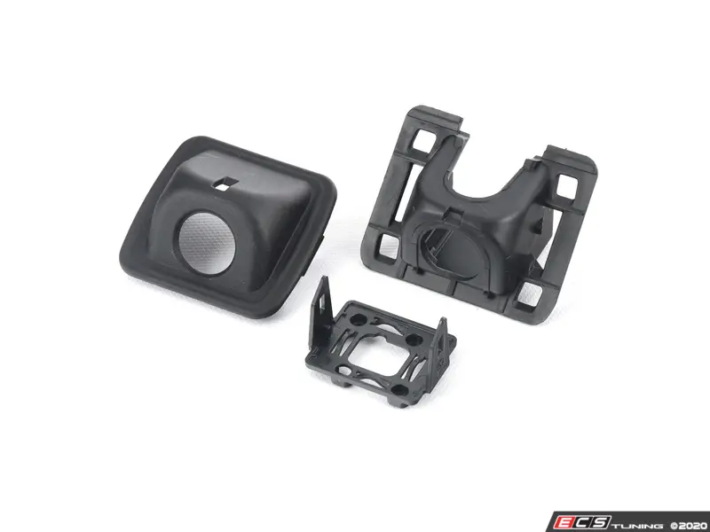

https://www.ecstuning.com/Search/Sit...h/66539475687/
Found the kit trim for the back up cam for the F54 Clubman Also.
https://www.ecstuning.com/Search/Sit...h/51127370614/
Thats the part that might be broken.
