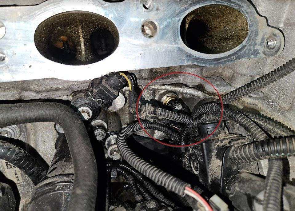

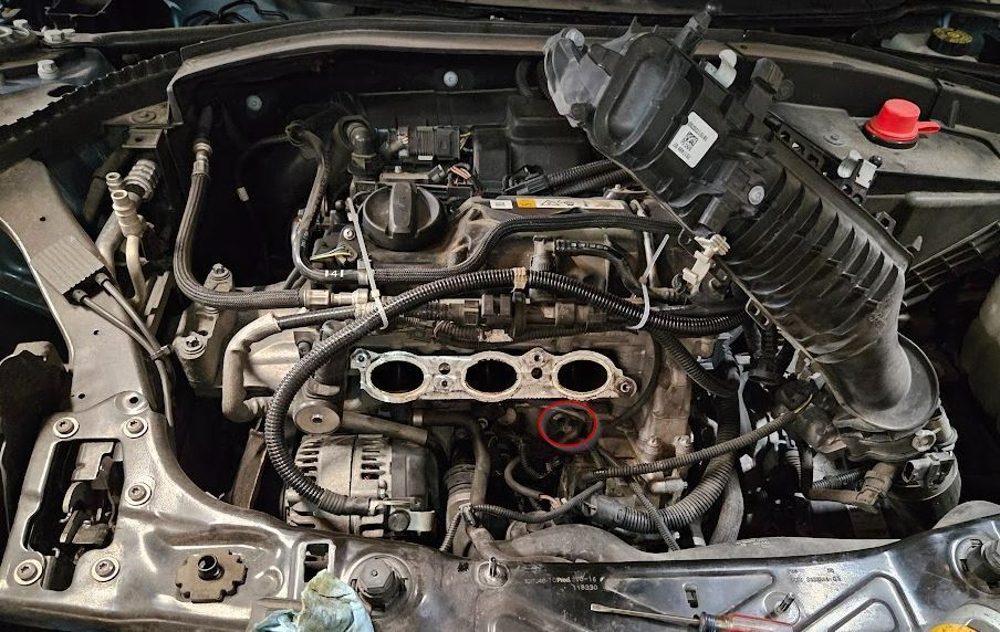

Answering my own question here. I found a some rough information on the location of the sensor, so I went searching on the car and found the cylinder head coolant temperature sensor in the top of the engine block on the front facing side. You have to remove the intake manifold to get to it.
