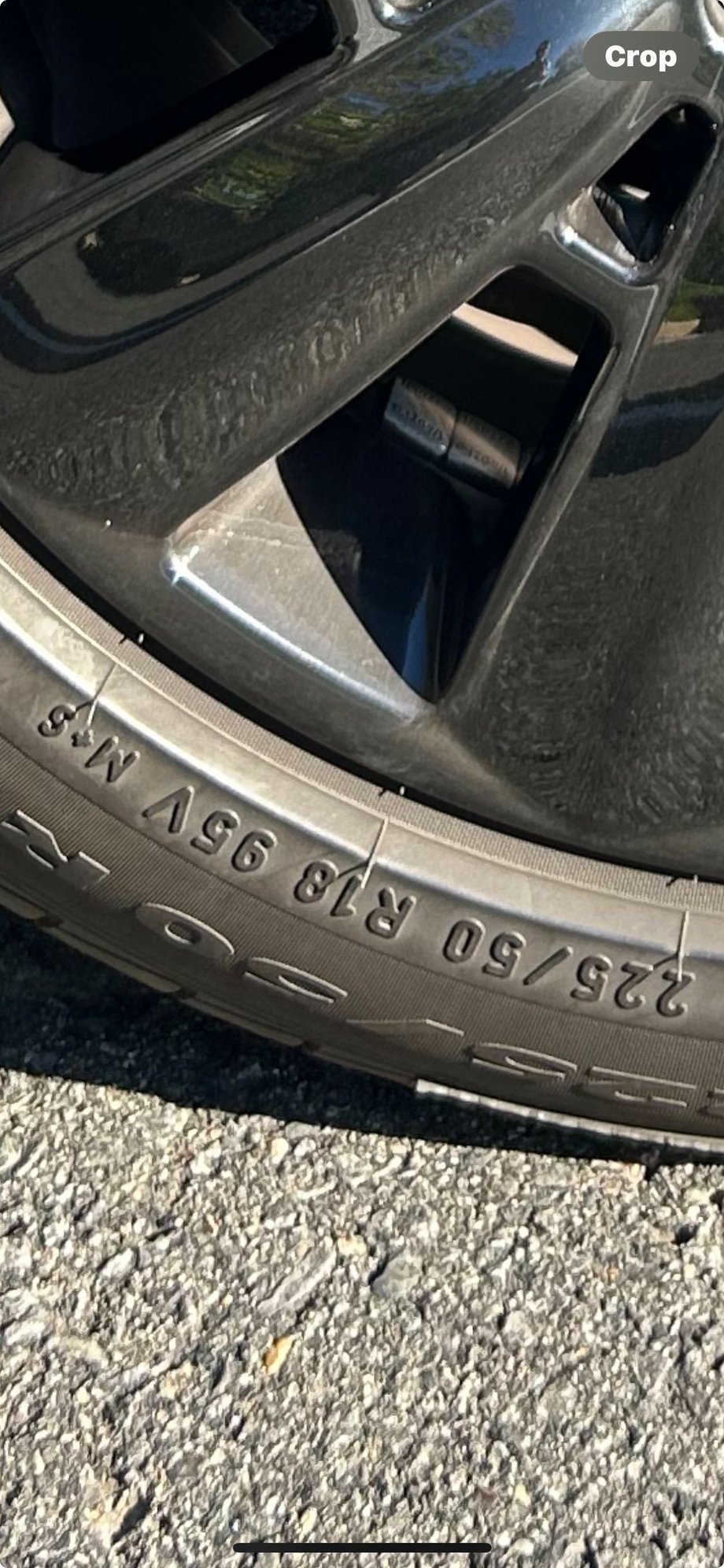

I was wondering a similar situation with our 2016 Clubman S, ended up installing Countryman's 225/50/18 with Cinturato P7'S - so far no issues with rubbing while turning or going over speed bumps, haven't had the car full of passengers yet, We tried the Speedo with a phone app and it was accurate, and the car read the new to us TPMS sensors without issues, hoped someone finds this pictures useful - I'll be changing the tires to 225/40/18 eventually, Safe driving
