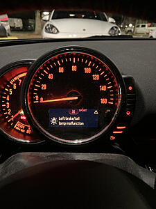

It's something on the left side. I never pressed the brake pedal (it often happens when I first start the car, it's a stick, so foot is on the clutch, not the brake), so it's something that comes on with the taillights.
But I'm pretty sure it's a bumper-mounted taillight because every once in a while, I'll notice that one side is dimmer than the other when I open the barn doors while the car is locked.
All bulbs are actually fine, and the warning on the dash usually goes away within seconds of appearing. I was ready with my camera tonight.
