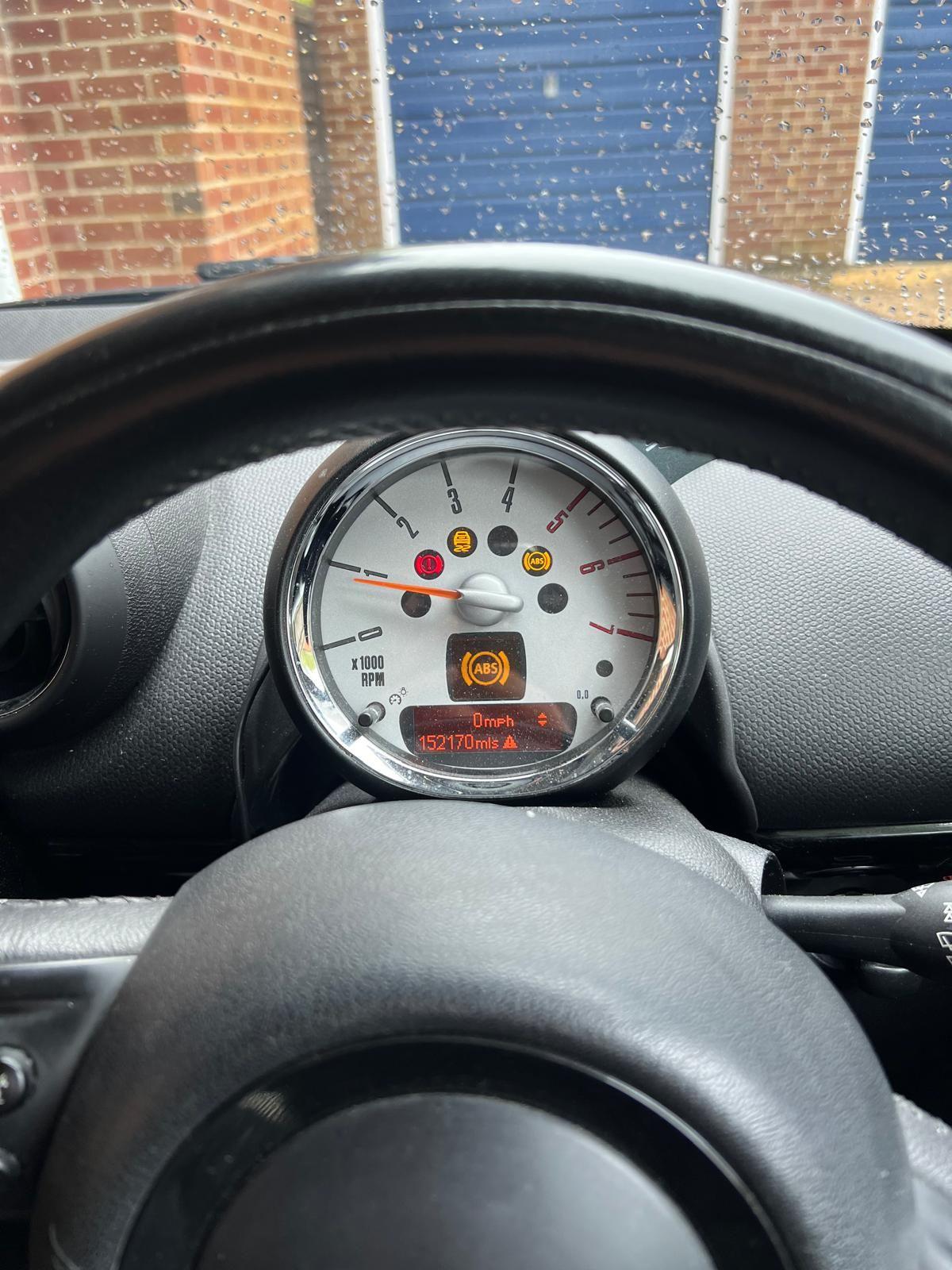

A year ago it experienced a very brief stutter (less than half a second) when driving steadily above 55mph. It never happens at lower speeds, in town, or under acceleration—only at constant cruising speed. This fault reappeared 4 months later and steadily got worse. It now occurs every 5 to 10 minutes. The issue feels electrical—just a sharp loss of power for a fraction of a second.
Alongside the hiccup, 3 orange warning lights sometimes flash up:
  • ABS
  • Anti-skid
  • Tyre pressure (not always)
Cruise control always deactivates when this second fault occurs. These warning lights only appeared twice in the first year, but since I replaced an ABS sensor (which was showing an error), they now appear far more frequently.
The two faults seem connected, but this morning the warning lights came on when I started the Mini from cold.

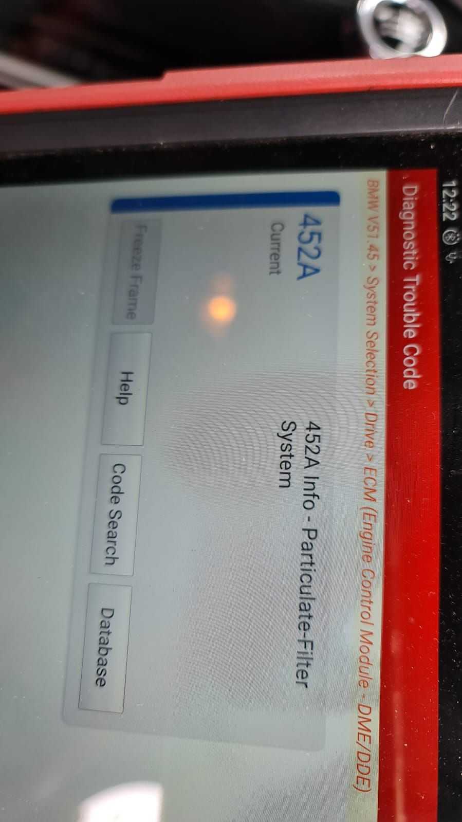

  • Another local mechanic ran diagnostics and found error 452A Particulate Filter System (image attached). Given the high cost, he offered to clean it but said that 4 electronic modules are involved, and warned that replacing them would exceed the car’s value. He advised scrapping my Mini!
I’d rather not scrap a car that is otherwise perfect as I’ve looked after it carefully, so I’m reaching out to see if anyone has had similar symptoms—brief high-speed stutter, warning lights, and a 452A code—or if there’s any known electrical fault that could cause this.

The code you are getting are not really related, did you have a footwell module recall in the UK? Looks like its an electrical issue. Here in the USA we did with the sunroof drains leaking and dripping water on to the floor an footwell module.

Good afternoon and thank you for your time and expertise. My Mini does not have a sunroof but that is the error code. I can only add that the hiccup does not occur once the orange ABS and anti-skid warning lights have appeared as a consequence of a hiccup.
