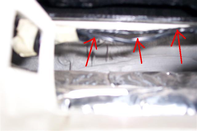

When you remove the black cover the plug is located inside taped to a frame rail for the body. You need to get down low and look up into the compartment.

I got my lamp and switch panel from Classic Mini as well. I found the wiring harness up inside the bumper shell taped in place like others have described.

Piece of Cake!
Thanks for everyones help with this rear fog light.
Now all I need to do is install the switches.
Took these pictures for anyone else wanting to add a rear fog light, one is blurry but it should give you the idea where the wire and plug is located.
Thanks again!
Rick

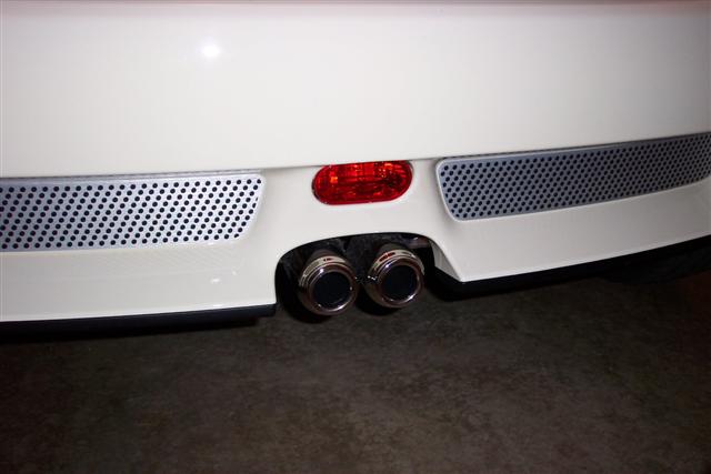

Got my car coded today! Found a spot in Oakland , ca that did it for $110.
Here is a pic of it on. I had a hard time finding pics so I thought I'd share.
28
